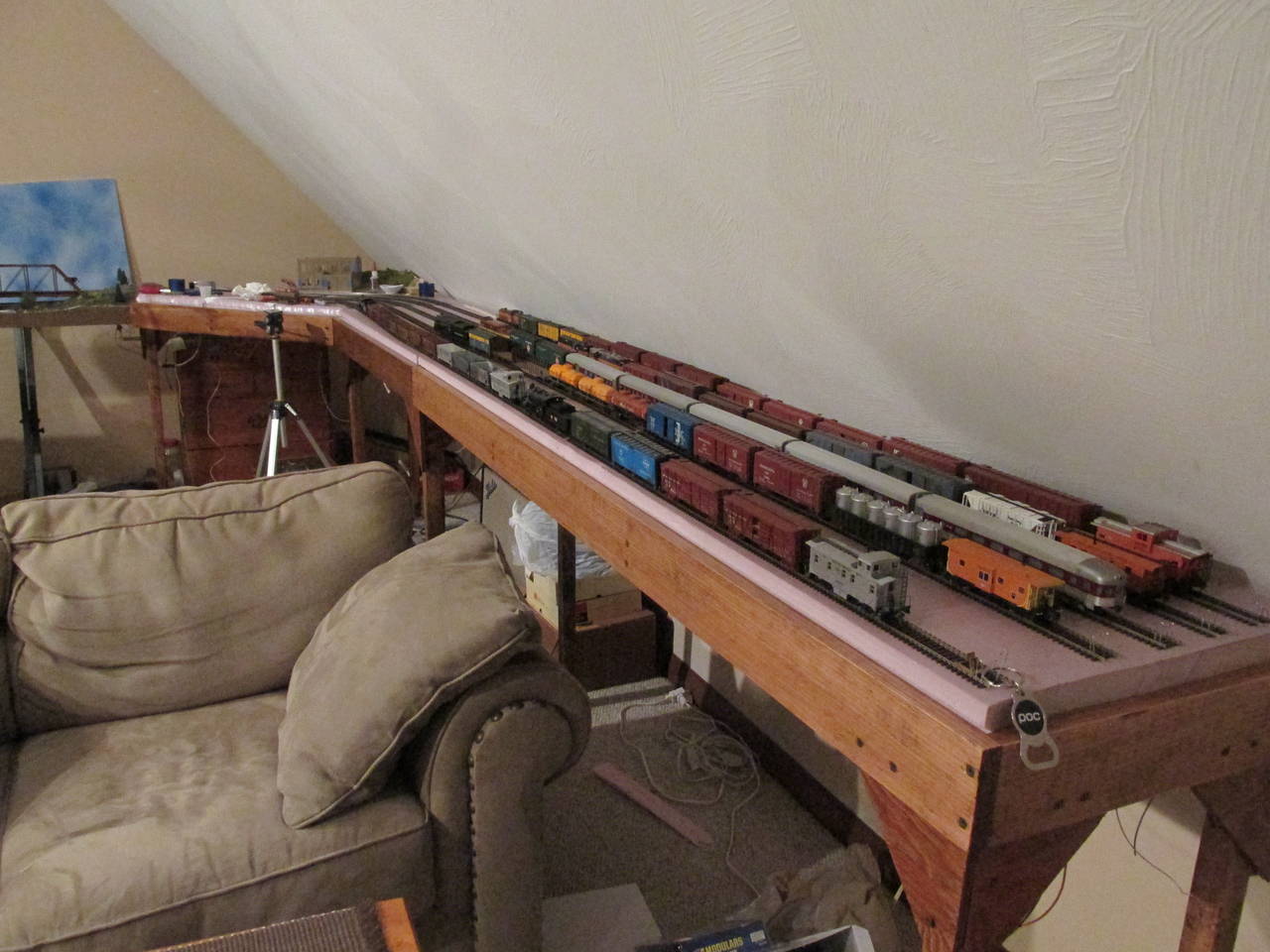

This is my staging yard, still under construction:
The far left track will be extended another 6 feet, and will be a branch line. The other 4 stop where they are.
In this case, “fiddling” is a bit awkward because of the overhanging roofline and tight track spacing. I plan to put a liftoff scenic cover over all but that branch line, but it will be removeable.
I’m still working out this operations stuff myself. This is a single-ended yard, so trains will return facing the wrong direction and will need to be turned somehow. The branch line track looks to be a good spot for manual handling, after which the train could be briefly taken out and then backed into the staging tracks again. Or, I could just tie up the main and back them in.
Richard…
