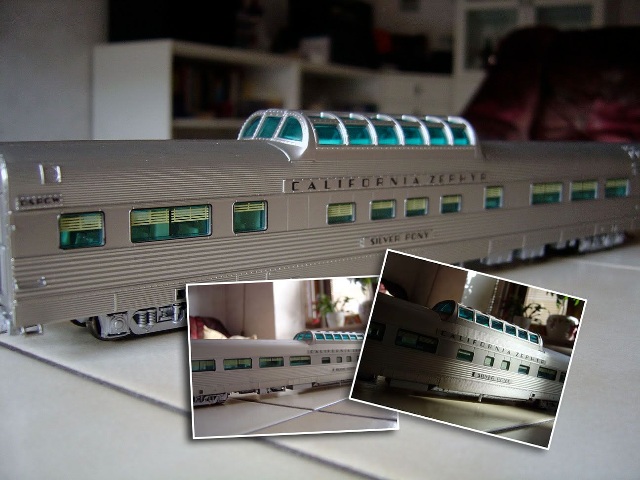

I have 5 CZ cars right now and I’m waiting for 6 more. They are very nice cars. I really love the Silver Sky… Here is a picture of my Silver Pony.
