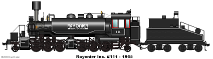

I have found the running gear for it which will be the gear off a 0-8-0 Rivarossi or Bachmann. Then the tenders will probably be old Bachmann 8 axle Santa Fe’s that have had their rears squared off. Maybe one will have a slope back…
The tanks on the locomotive itself will be either another Santa Fe or scratchbuilt and it may also have a slope front.
Something similar to this… Just without the coal bunker on the cab another tender on the back and the tanks square not saddle style.
Bachmann made a very nice USRA 2-6-6-2. It’s far smaller than a Big Boy, though larger than a logging articulated. The same locomotive has been done in brass.
Logging articulateds were very small, and typically had 44" drivers. If you added one or two auxiliary tenders to one, you’d have a locomotive that could pull a small train slowly for a very long distance. That’s not something most Class 1 railroads yearned for.
If you use the Tyco logger, it gets better, because it’s oversized. I think it uses 51" drivers. So you’ll have a locomotive that will pull a somewhat larger train a bit faster over a long distance. A distinct improvement.
The USRA 2-6-6-2 had drivers of 57" (still small, but 30% bigger than a logger) and pull twice as much.
