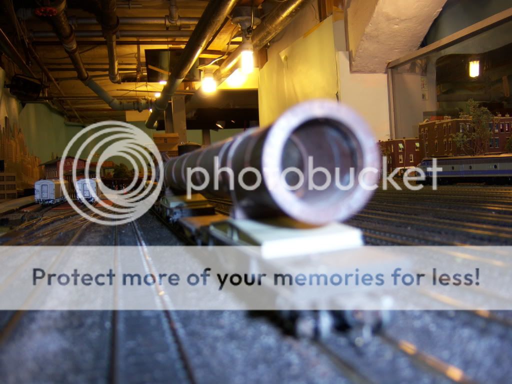

Here are some prototype photos taken by a friend.
Notice the end protecting canvas is of different color. Not all units are tapered and they are also of different length
Only one end is chained and bolted to the flat car.
The opposite end simply rest on his supporting cradle
Notice the protective cushion.
Close clearance with the bridge.
If you need more photos, PM me and I will email them to you.
Wow! Those are some great photos Jack. Thanks a lot, that really helps me out.
Judging from the overhang, I just measure my cars, so I’ll need the PVC pipe to be 1.5" on the outside diameter.
And for the bases, looks like I’ll have to use some pieces of styrene.
I just finished weathering both cars today. Tomorrow I’ll pick up the PVC pipe, styrene, and scale chains.
