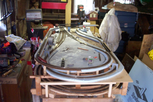

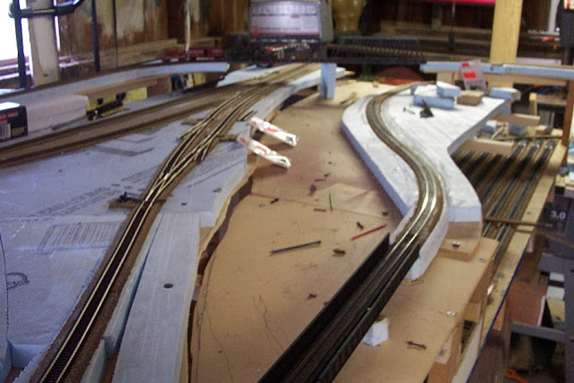

Yes. I used 3/4" foam sandwiched to 1/4" Luaun plywood.
Like thusly.
and thusly…
I needed the thin plywood to achieve some tight clearances where the loops cross. With adequate bracing it’s held up for years with no problems.
