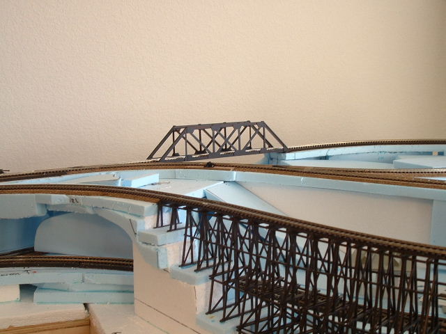

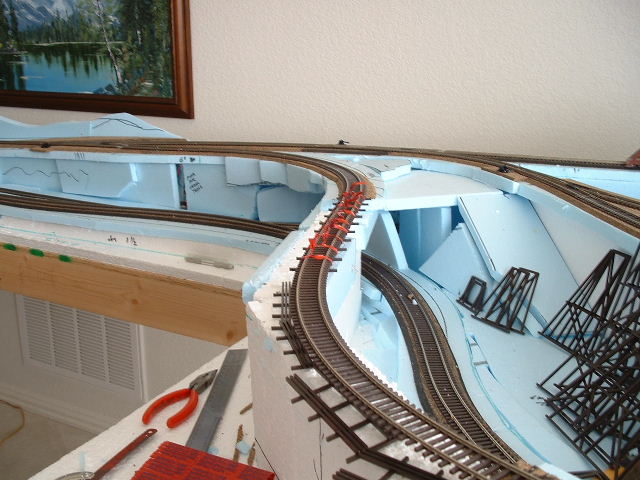

The 1/2" foam superstructure gets its strength from the “box girder” effect of the construction. The photo below shows a good example of this “box” effect.
The cookie cutter sub-roadbed is supported by vertical “walls” of the 1/2" foam which are glued to the foam base sheet and, of course, to the sub-roadbed forming a very strong box-like structure.
Even though the riser wall sections may be cut in short lengths to make cutting and fitting easier the sub-roadbed and base sheets are mostly monolithic. The resulting structure has many of the qualities of box, “T”, “L” and “I” beam girders making the overall “superstructure” very rigid and strong.
This is all held together with white glue which is strong and easy to use and clean up.
Once the foam “substructure” is covered with hardshell and scenery it is even st
