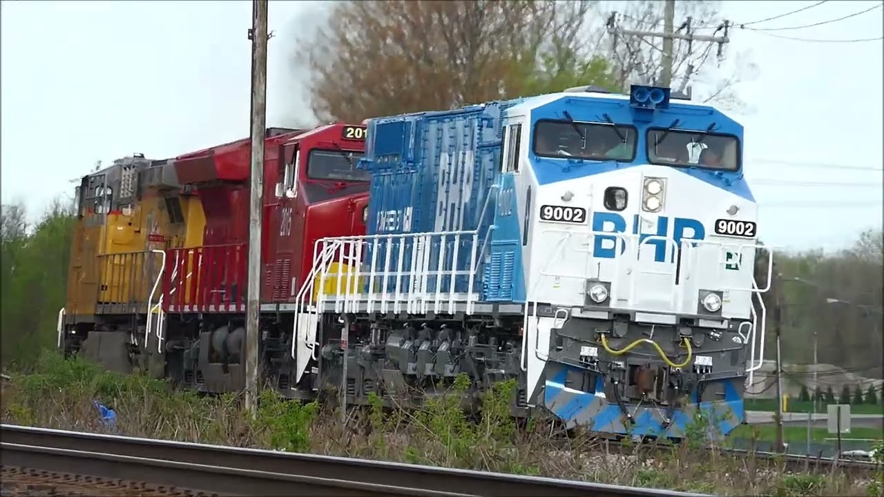

From my hunting around on the status of the FLXDrive locoās, it appears that BHPās units have been/will be shipped to Australia sometime in the near future.

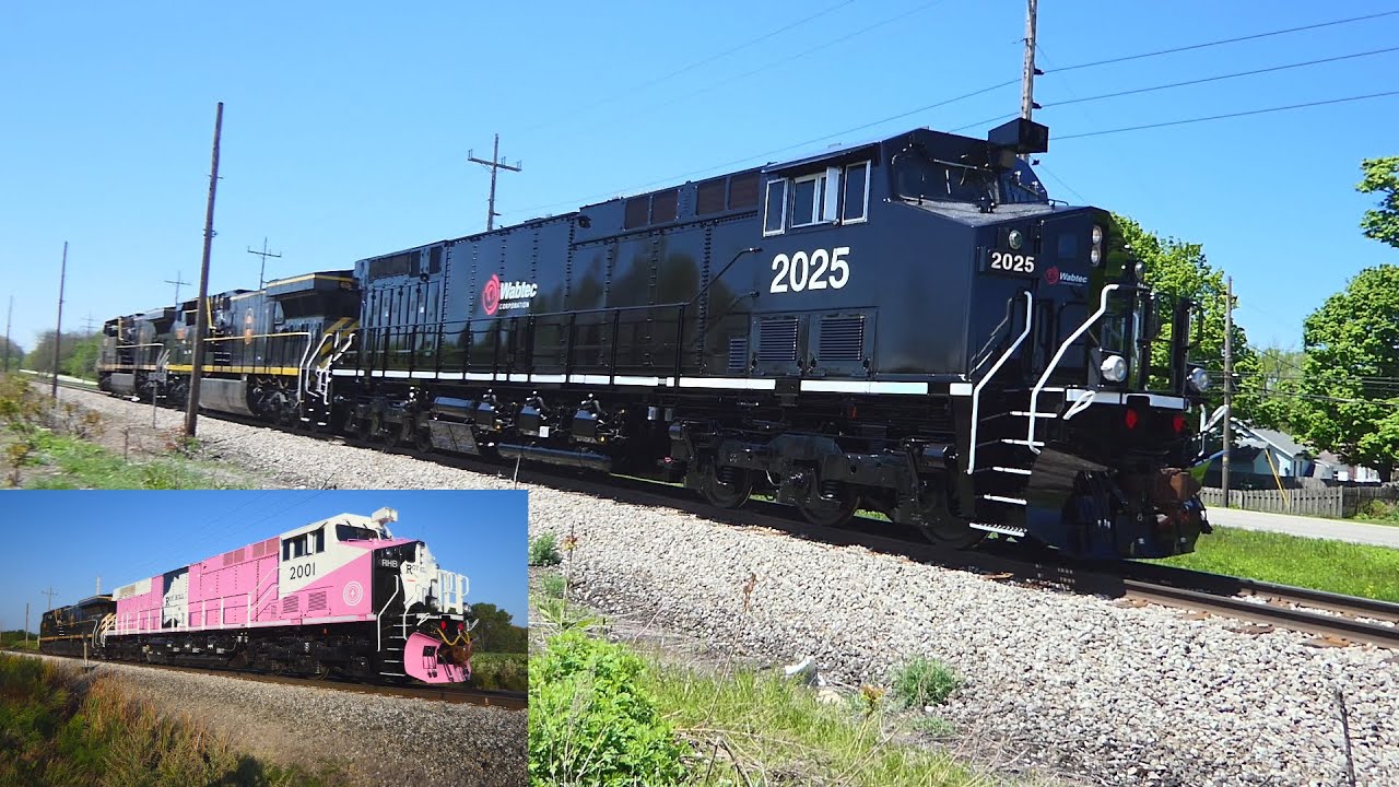

Hereās another video of the initial, now ex-Roy Hill, FLXDrive loco:
