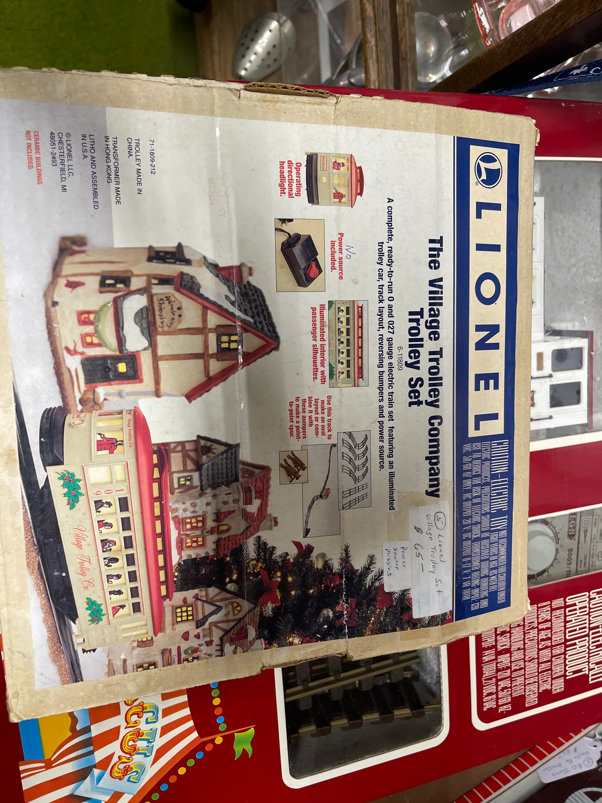

Found this set at a antique store Lionel village trolley
But it is missing transformer. Anyone know where to find a replacement? 65$ for the set seems reasonable

So, that would appear to be a DC power pack. So, are you looking for a power pack that would be suitable for running the trolley or are you looking for an exact replacement?

If you are curious what an original should look like, I’m fairly certain (can’t dig out mine to check right now) it’s the same one shown with this similar set on Trainz.com. (edit: Face-palm as I realize a picture of the original is right on the cover of the box! :man_facepalming: .)

I enlarged the photo and that looks like a generic DC transformer you’d get with a Bachman N or HO starter set. You can sometimes find them at train shows for $5 to $10. trainz.com may have some on hand or you can check a local hobby shop. If you’ve got everything with that trolley set except for the transformer for $65 that’s not a bad deal. A new Lionel Christmas trolley’s selling for $166 to $185 depending on the seller.

The transformer is/was a Bachmann #6607. It appears they or Lionel made a different case with the Lionel info as Lionel #4660. The specs are 0-17 VDC for track, 20 VAC for accessories, 7A total max out.
