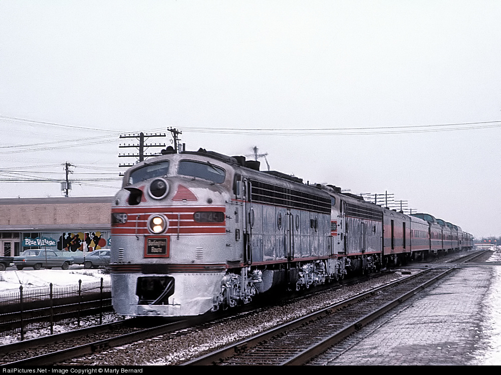

CB&Q got into running their E’s nose to tail:
I view the concept as “aesthetically questionable”. They had relatively few B units in their passenger fleet. Say, as compared to UP. Of course, this also meant that “any” engine could lead, since “any” engine had a cab. A true convenience.
But also (especially if you’ve got mostly A units), I think it’s the most aerodynamic setup of multiple A’s. That is, it saves fuel. That is, it saves money.
And, of course, it answers any questions about which units get turned for the trip back: all of them. And, I’m convinced that at the “end” of each trip,there was a turning loop/wye for the whole engine set. As opposed to a turntable.
Ed
