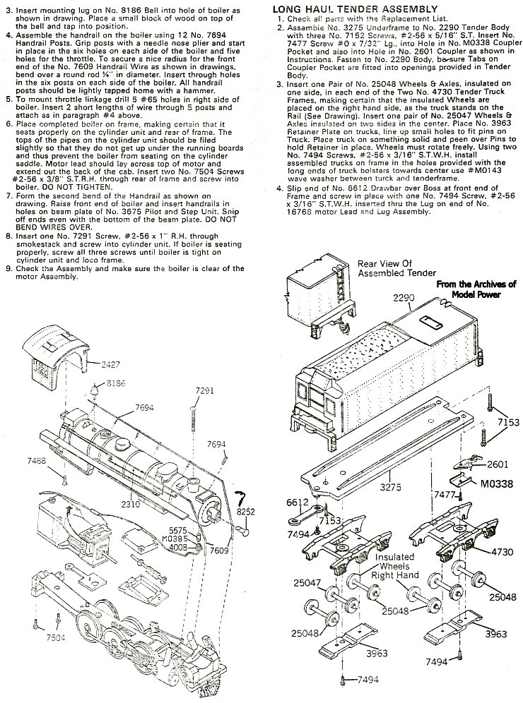

The Franklin Mint locomotive is most likely a Mantua(Tyco). Check with someone who has the Hudson model for instructions.
Or check the hoseeker site for Tyco.
http://hoseeker.net/mantuainstructions/mantua464hudsonpdinstrpg6.jpg
However, the shell of Tyco steamers were usually secured by a screw through the smokestack.

On many brass models the screw holding the pilot is a King Pin, which also holds the boiler in place.
