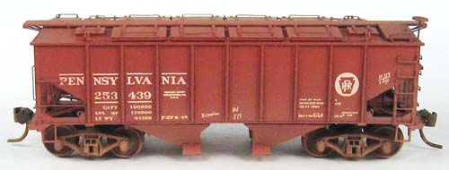

Pennsy way of converting open hoppers to covered ones.
Funaro & Camerlengo new Pennsylvania Railroad GLe Covered Hopper kit
http://www.modelrailroadnews.com/channels/ho-scale/single-article-page/pennsy-gle-covered-hoppers-recapture-a-time-of-transition/712f44ef3c.html

Finally, those beautiful H30 Pennsy hoppers arrived in the old Europe! [8D]
I have to say, this car is one of the most detailed I ever saw. Great job, Bowser! [Y]
