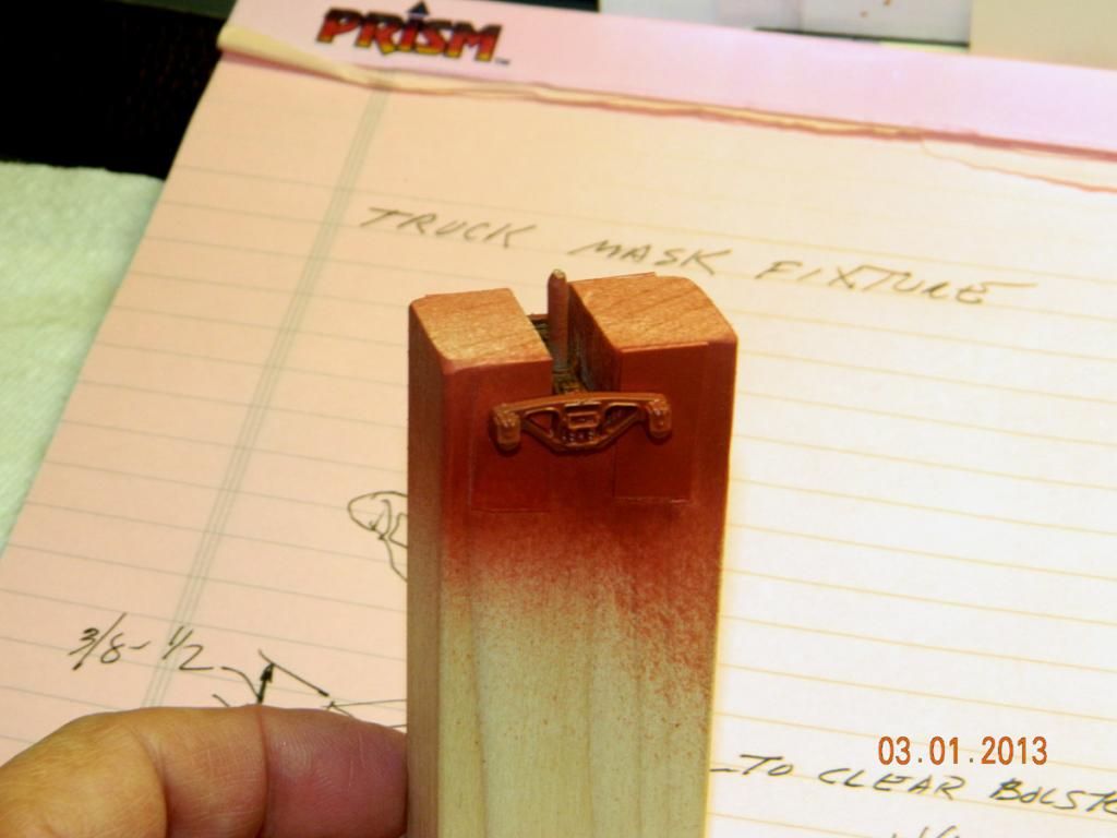

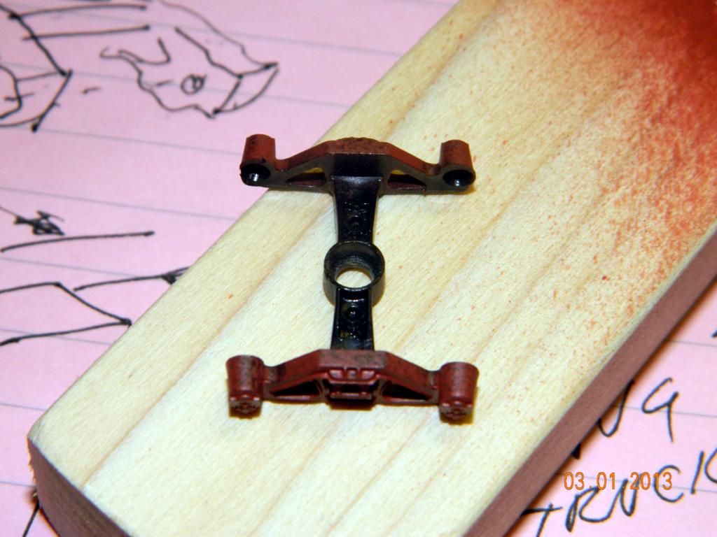

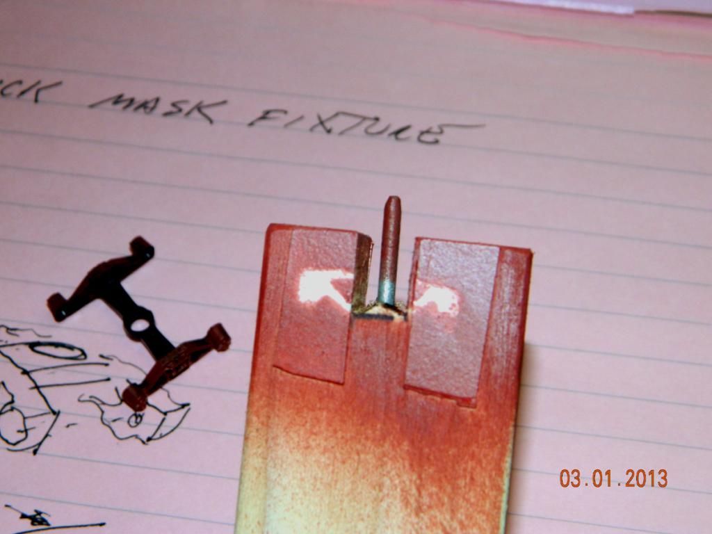

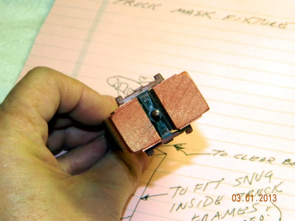

I was looking at an article on weathering and they used a set of old wheelsets to cover the axle holes in the truck frame while painting the frames. This gave me an idea for a fast spray masking tool and it works great. Thought I would share it with you all. I used a piece of poplar 1 x 2 with a notch cut in it to clear the truck bolster (with wheelsets removed!) and then glued a few strips of .030” styrene to build up the thickness and make a close fit between the truck sideframes. I also added a nail with the head removed to act as a support/guide. I tried it with a rattle can to test it and it works great and takes about 10 seconds to load it and even less to remove it.

Thanks guys, I just did this today in about 20-30 minutes. I have a full woodworking shop in the basement below my layout room so these things can be done rather fast and painlessly. I plan to make more or multiple ‘stalls’ if you will, but had to try it out first. Glad you like it and can use it.

i hate to nit pic but,—you are able to paint the top of the bolster which is completely hidden when it is on the car but you can not paint the sides of the bolster which often show under the car depending on how you look at it.
still, the bolster is not that easy to see and painting the trucks as you have done looks pretty good.

I used a bandsaw and then filed the bottom flat (didn’t want to bother setting the table saw?). I may try my next one without a notch at all. I just realized I can just put some pins (nail with head cut off?) on a 1x2 and the truck sides will still set below the top of the board; much easier and you can space out the nails for as many as you want. Just a thought, but I haven’t done it yet so it may not work as well. Will try and see what happens. Thanks for the comments…
WELL, FORGET THE NEW BRAINSTORM IDEA, YOU HAVE TO CUT NOTCHES OR THE AXLE HOLES WON’T BE COVERED!!!
