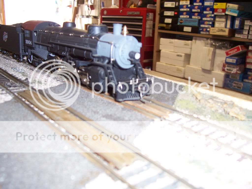

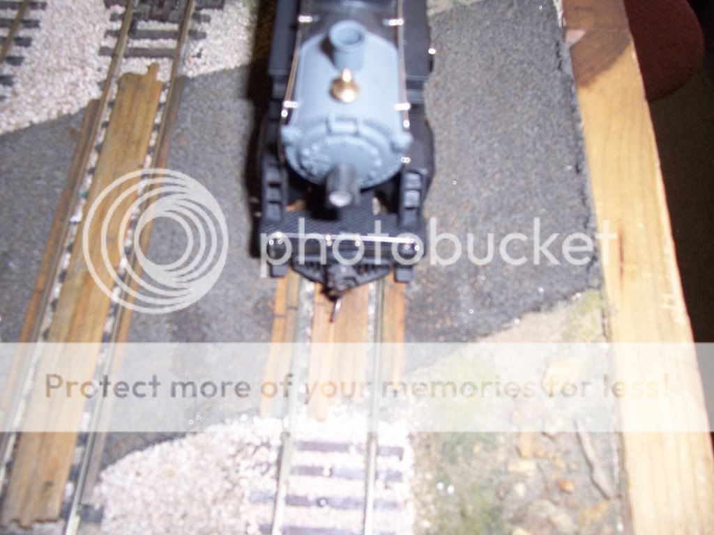

Here are some pictures of one IHC mikado I did. I sold the 2-6-0 no pics of it.
104_3553.jpg image by Buddman31
104_3557.jpg image by Buddman31
104_3555.jpg image by Buddman31
104_3556.jpg image by Buddman31
I am still learning the picture thing. hopr you can see these better.
104_3554.jpg picture by Buddman31

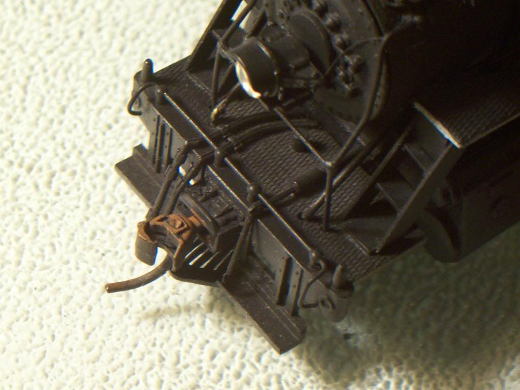

This is the HowTo what I did. Following an idea from my friend Friedhelm:
Wolfgang
Very nicely-done upgrades to that loco, Wolfgang. [tup]
