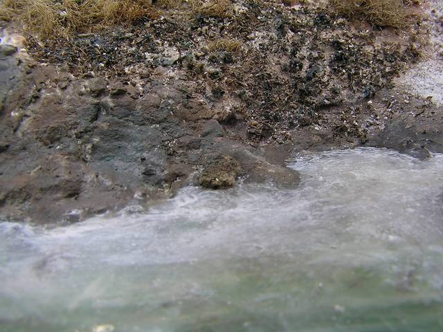

I modelled a small amount of ice on the edge of my epoxy resin river.
If you wanted ice all over I guess the resin would be a needless expense. Mine is painted mostly white with a touch of blue plus some acrylic gloss gel medium [as Elmer suggested] all swirled around with brush and fingers.
