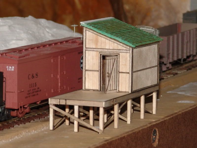

Here ya go…

There are two ladders that attach to the platform but I haven’t added them yet.

Hello That’s a nice looking milk shed I think I am going to get one. Thanks for posting the pics. Chad that truck bed is cool. Both of you guys did a very nice job on your kits. Thanks for all the help Frank
Do those doors come printed that way, or is some assembly required? The reason I ask is that technically, I think, the diagonal brace should go from the upper left to the lower right (hinge side). I believe that this is to keep the (prototype) door from sagging.
Seems that the diagonal is correct to me. The support for the lower door portion is attached to the side frame on the upper hinge side. There by holding the lower, outer portion of the door up.
The doors require assembly (adding the Z bracing to each side).
I followed the instructions given in the kit as to the orientation. Guess I screwed up. Thanks for pointing out the mistake, but there’s nothing I can do about it now. Perhaps I’ll have to buy a new kit now and rebuild …
It’s always something…[*-)]

Well, I could be mistaken, but I’m pretty sure I’m correct. I think the idea is that with the diagonal as shown on the model the diagonal will be in tension and will be prone to being pulled apart. On the other hand, if the diagonal goes the other way it will be in compression and harder to pull apart or sag. Here is a link to a picture of a similar door except that there are two braces (diagonals). You’ll notice that both of the diagonals start at the top outer edge of the door and go toward the lower hinge edge of the door: http://www.secrets-of-shed-building.com/building_a_shed_door.html
After rethinking it, i believe you are right. Compression is better than tension in this case. [:)]
FWIW the diagonal goes the other way on the inside of the door…
