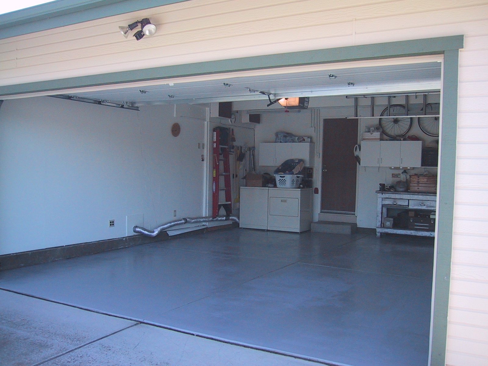

After evaluating my available house space for where to construct my latest HO Model RR, I’m planning on setting up my layout in my garage which has only an outside entrance. I live in So. California if anyone knows the weather here, it gets hot in the summer (100s) and can get down to close to freezing in the Winter.. Rain is usually around Dec. to March or April and the amount varies year by year. Problem is that my garage is not sealed like a room in the house, nice and finished with environmental control, insulation and airtight doors. It’s basically, outside Stucco wall against tar paper, 2 X 4 studs visible from the interior and that’s it. Big garage door is leaky all around the edges. There are air vents open to the outside with wire mesh for some unknown reason around the bottom of the walls. There is only one window so that’s not a problem. I’m concerned that my locomotives and critical electrical components will deteriorate in that environment. I think the rolling stock will be OK, not sure about how the typical scenery materials would be affected.
I was thinking of just taking all the electrical Locos inside the house after each session to protect them, although that would be a big hassle every time I wanted to operate the Layout lugging the Locos back and forth from inside the house.
Any observations or suggestions would be appreciated or advice if you have had the same problem.

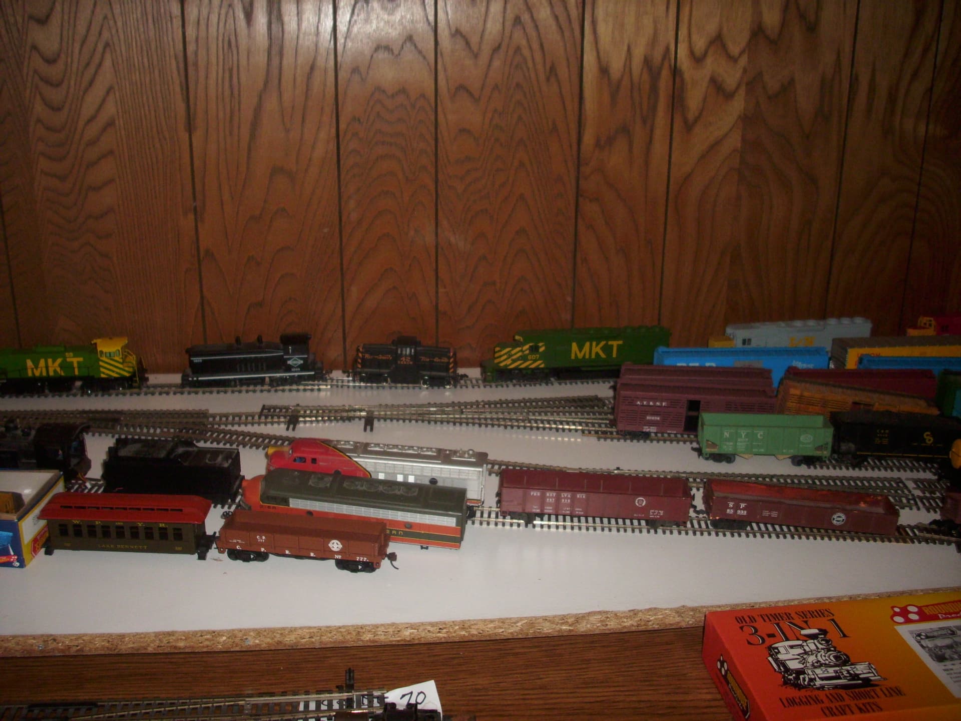

Theme will be a Short Line .that interchanges with a Class 1,with small yard, serves a couple industries and a mine community (coal or ore) in the mountains**. Maybe, 70s and 80s Era.
Also a tourist steam train & F-Unit with old passenger cars. Got all those cabooses in a special deal, which originated from an estate sale. Guess I’ll have to have a Caboose Track.
Will be lots of folded loops at different elevations. Yard will be at the lowest elevation, similar to what I see in your photo.

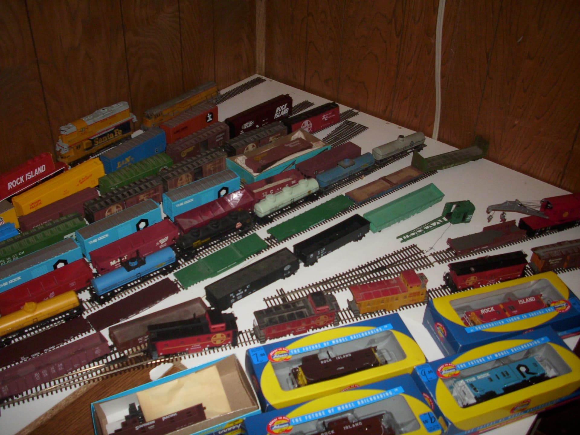

**I was taking inventory.of my rolling stock & locos here.
Athearn, Roundhouse, Bachman and Misc **
I plan on repainting or remarking some cars & locos as patched cars purchased from retired **RR Lines. That way I can keep the original paint scheme, like with the Rock Island stock, ** which has nice graphics.. Have lots of Kadee couplers and will replace any that don’t with Kadee.

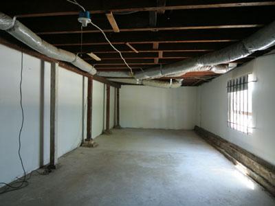

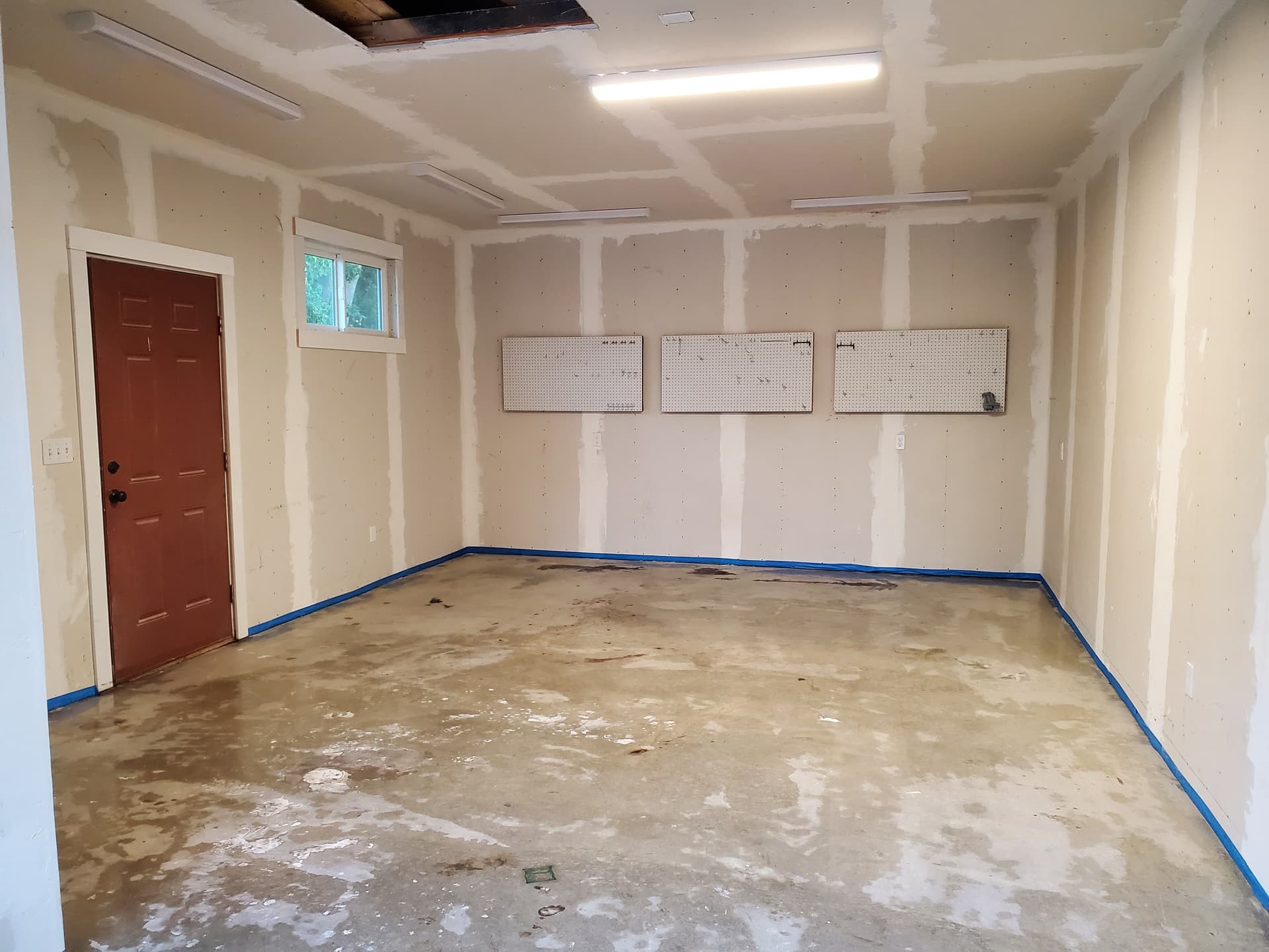

Before I moved this past spring, I had just finished fixing up the detached garage that I had planned on using for my layout and art studio. This was the last update video that I did on the work showing the work I had done as well as the costs. Granted, I’m in Ohio, so there’s going to be some differences, but hope this look at what I did with my garage helps.
Kevin
Your post shows the absurd cost of finishing an unsealed bare bones garage just to have a
model RR layout. Maybe if you are Wealthy it makes sense. I suppose to some people
money is of no concern.
No offense meant, it’s just that not everyone can put out 16 Thousand $$ to upgrade a garage
so they can put in a Model RR layout.

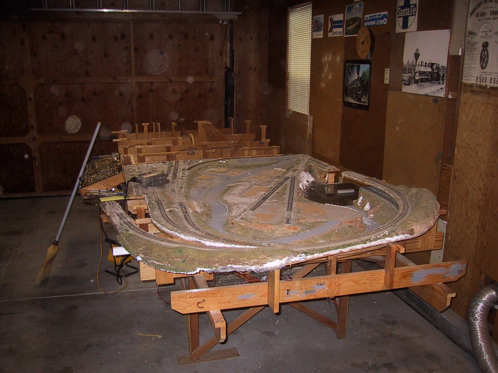

Thanks for the kind words and sorry about the late reply, other than add a rubber strip to the bottom of the wooden tilt-up garage door didn’t seal any cracks, nor add any insulation. The garage door had some sizable gaps on both sides, luckily on the lee side of the house. Again, glad I didn’t wait to finish the garage before enjoying a layout. Though in retrospect some things could have been done piecemeal as time and money became available, like adding insulation, wall board and a threshold (also helps keep out the mieces’) to the side door.
After tearing down the old layout which stood in good stead for 22 years was fortunate to have the time and funds available to finish out the garage before building a taller point to point switching layout. A lot of the lumber from the old layout was used on the new one.
Btw, those two grandkids in the previous photo can no longer be trusted, they turned 30 this year, but I digress. The finishing job was no where near as expensive as Kevin posted, but that was 14 years ago and was fortunate enough to do most all the work myself, except for installing the insulated roll-up door. Skipped a built in heater-AC. Model Railroad aside, it is nice to have a more comfortable and stable space to do other projects, the laundry, work on the vehicles, storage, etc.
