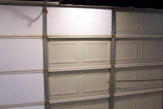

Sounds like you are in a tough spot for your garage. I am in the same boat, sorta. In the garage, but it is a rental so I am very limited to what I could do. I am not sure what kind of garage door you have but I would get that sucker insluated if you can. I did on my garage and made big difference.
Also, if you can vent it somehow, rig up a fan on a timer…What I did was installa fan that turns on at 12 pm and runs till 4 AM. it sucks all the hot air out and brings in the cool air from the night. Atleast in the mornings it is sorta OK. Some times the small vents dont work to well so I wil crack the bottom of the door, just a smidge, one inch is all you need, and that will allow plent of air intake.

spidge, the earlier comment about insulating the doors worked for me. I did mine with a kit from HD for $180 - that really seems high for some foam panels doesn’t it?

Tom, the garage door I have is insulated but very thinly done. It does face the afternoon sun until about an hour before dark. Thanks for the idea, I may look into some additional insulation for it.
I found a great idea on how to cover up that nasty garage door. Once you get the insulation done, head on down to the local cloth supplier and look for the largest, cheapest “sky blue” materail you can find. My wife and son went with me and we scoure dover the store and came across this. I ended up buying the whole bolt for my porject. Cut and hang! I even added some clouds by airbusging directly on to it. Worked great.
I have a door just like the fellow above, multipanel type roll up. If you secure it nicely, maybe some screws right into the foam, it will roll up just fine with the door. Which is a heck fo trick cause then you have the door open and blue sky above. I think I spent around 35 bucks for enough to this, and about 12 extra feet for other areas. Since I cant paint my walls, due to beng in a rental, I have been useing this as my blue background. Just be prepared to iron the snot out of it.
