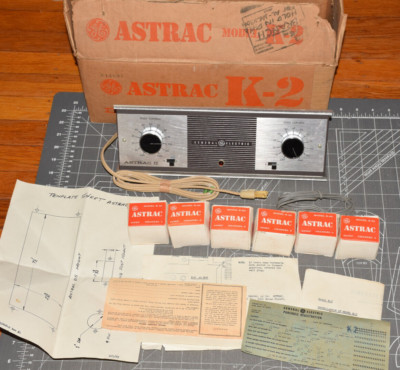

The only thing I can recall that GE did for the model railroad market was the ASTRAC control system.
GE seemed to be big on developing technology then quickly selling off the rights to other companies.

ASTRAC.
No, I finally found the book I was looking for. 34 New Electronic Projects for Model Railroaders by Peter J. Thorne. It mentions ASTRAC in the section on command control, but doesn’t go into it in any detail.
See the reference page I linked. It has PDFs and transcriptions of the discussion of the technology used.

I had similar memories. One in particular was an article about how ASTRAC allowed for on-the-fly helper decoupling. I was also puzzled by the Sutton’s book where he indicated that ASTRAC had a bright future after reading in MR that ASTRAC had been discontinued.
Thanks for posting the link! I had been wondering how ASTRAC worked, guessing that tone bursts were sent with timing based on the phase of the AC voltage which would be rectified and fed into the gate of an SCR. That’s pretty much what the documentation said.

I wonder if ASTRAC technology wound up at QSI because they sound very similar.
I don’t think they are much related, technically. If you look at the GE discussion, they were treating the model-railroad application as an early – and highly low-cost – introductory market for their midget SCRs. They used the AC ‘accessories’ terminals on a powerpack as their ‘track power’ and (rather cleverly, for cheapness) used the positive half-waves for one direction and the ‘negative’ half waves for the other… and charmingly noted in those carefree pre-polarized-plug days that if the direction didn’t match the switch, just turn the plug over rather than change the connections to the track!
All they did for ‘pulse width modulation’ was apply a higher-frequency carrier-current signal as a tuned ‘trigger’ for the SCR in the going direction. You will note that they do not carefully describe (other than circumstantially) how the SCR output waveform was filtered to produce a more ‘average’ DC-like voltage at the motor, and it’s a bit sad that they did not recognize at first that motor ‘impedance’ would affect their circuit behavior.
I was also chuckling sadly at the comment in the letter from the early Seventies, about how they were rediscovering the by-then-moribund ASTRAC tech… but had no idea about Linn Westcott’s transistor-throttle approach when taking it up.

What ASTRAC used is referred to as ‘AC Phase Control’ in the GE SCR Manual. It is a form of PWM, with the distinction of varying the amount of an AC half cycle versus the width of a constant voltage pulse. The circuit controlling the timing of the high frequency bursts is not much different from the circuits used for dimmers. I was a little surprised as well with the designers overlooking the inductance of the DC motors as it is a crucial feature with SCR control of larger DC motors.
ASTRAC came out when integrated circuits were expensive novelties, although the Minuteman missile project was then prompting ways of vastly reducing the cost of making IC’s. This required use of much simpler circuitry than what would be used now.

I was referring to the method of triggering the SCR (with the superposed carrier-current ‘square’ wave), The interesting thing is that they recognized how to get extremely short effective pulse duration out of this type of SCR… they don’t turn it on until well on the falling side of the half-wave AC. At some point no sensible amount of LC filtering is going to give ‘constant’ DC voltage, even ripply… it will be the kind of pulsed PWM excitation that overcomes motor ‘stiction’ for brief duration, but well off the non-RMS voltage peak of the half-wave AC which would be ‘better’ if it could be cheaply switched.
I was very familiar with SCR control of exercise treadmills (where you do full-wave rectification at 120pps and trigger relatively late at slow speed, but with ginormous filter caps the size of beer cans. What I found interesting was that the original generation of control board was set up for ‘hard following’ of speed control. Turns out that induces shin splints or worse as the motor slams into high torque at footplant…

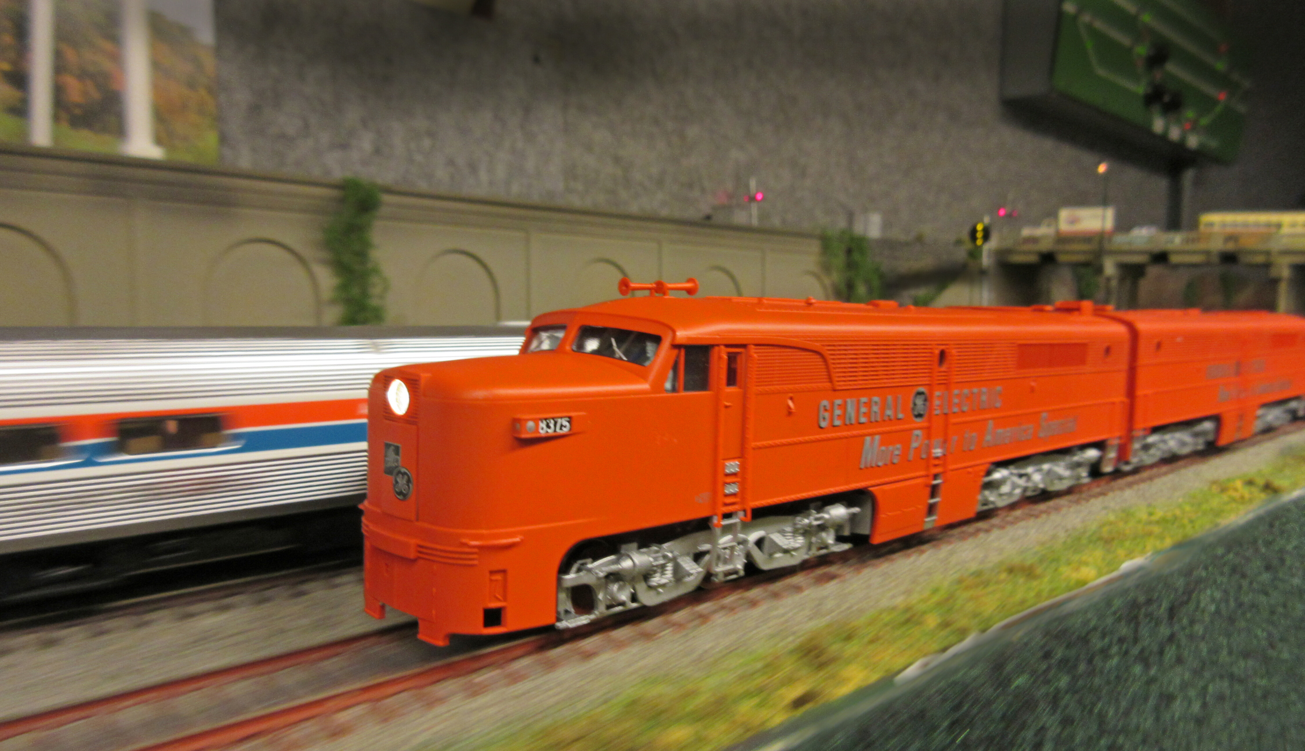

Well, there was the 1950 More Power to America train…
PA-2 GE More Power to America by Edmund, on Flickr
Regards, Ed
