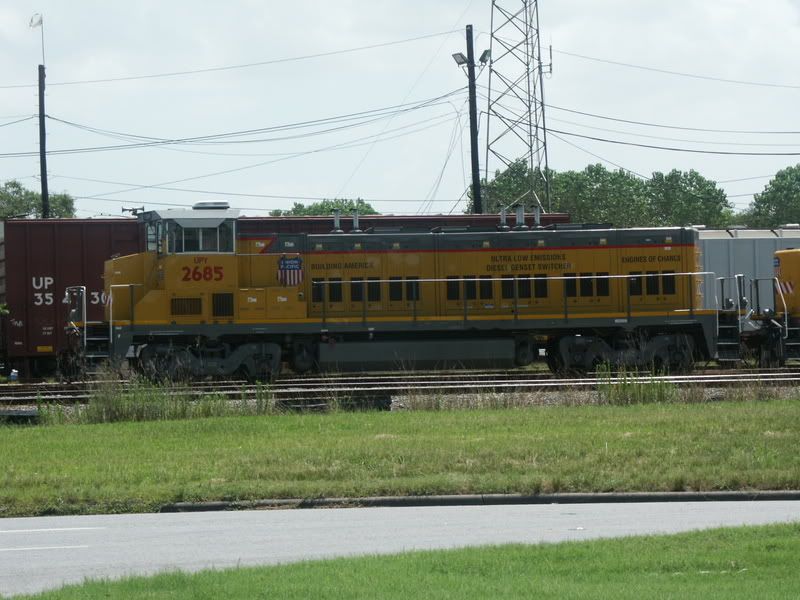

We have had one running around UP’s Englewood and Basin yards, and once in a while at PTRA’s North Yard for a few days, MUed to the 2101, one of the re-engined GP50s…doing yard to yard transfers.
Thing sounds funny, like a heavy Mercedes diesel truck.
Here it is at the Basin tie up track…sorry about the quality, it was 1 in the afternoon, the sun was straight up and I was on the way home and didn’t want to hang around any longer than needs be.

I haven’t figured out the exhaust stacks arraignment yet…looks like they have one diesel up front, and two in the rear, with the alternators in the middle of the long hood…might have to climb up on one when next time they park it at the port…
They are advertising on the long hood, it says “Ultra Low Emissions Diesel Genset Switcher” and “Engines of Change”.
Are they typically just used in switching?
Yep, looks like three engines/generators in one unit- did a google search and found an interesting presentation:

Every once in a while we’ve seen these UPY2600s go through here en route to Texas. They don’t linger very long.
The UPY 2700s are being built for California service, and look a lot less cluttered on the hood than these–three sets of everything, and three stacks. I still think we may have commandeered a few of them and added RCO capabilities so they can be used here.

As I recall, among the ‘features’ of a genset locomotive is that they are modular. If one of the gensets fails or needs work that would otherwise take the locomotive out of service (other than the routine stuff), it’s a “forklift replacement.” Out with the old, in with the new. Then the maintenance folks can work on that particular generator ‘at their leisure.’

From looking at the long hood, I think you nailed it…seems as if I remember seeing a photo of the diesels on skids for quick replacement…think it was in Trains a few months back.
