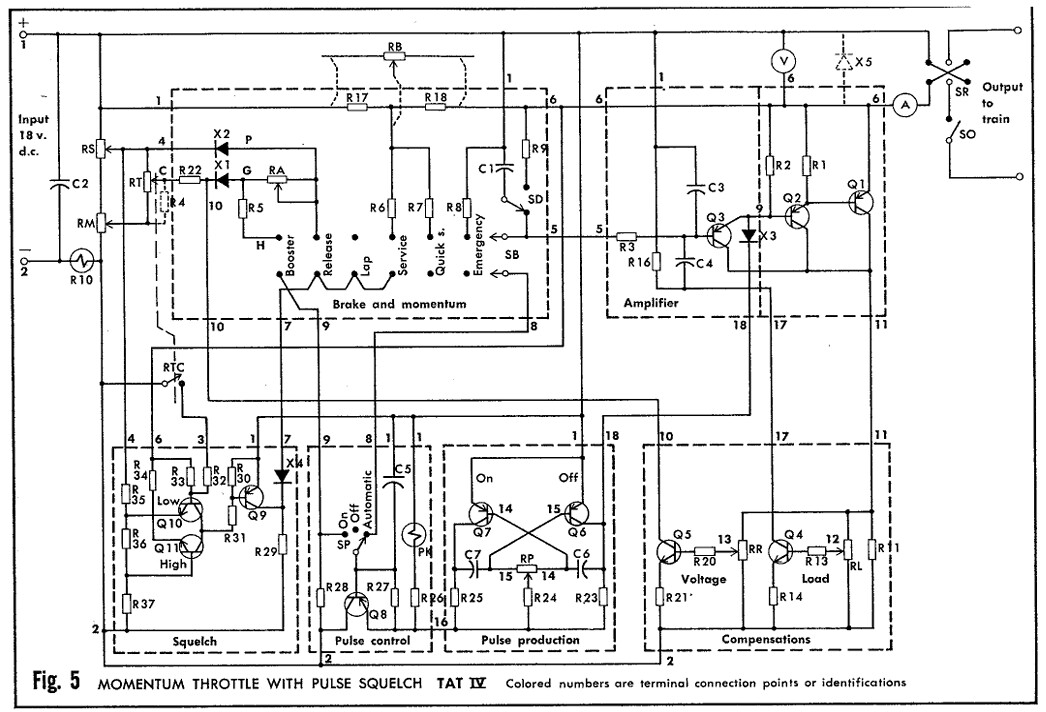

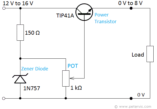

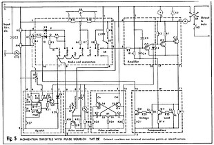

but if you want filtered DC, just buy a transistor throttle with a circuit as follows. Linn Westcott started with this type of circuit in his Feb '62 series on transistor throttles, but eventually added a periodic pulse to overcome stiction (see pulse production circuit in the Tat-IV)
