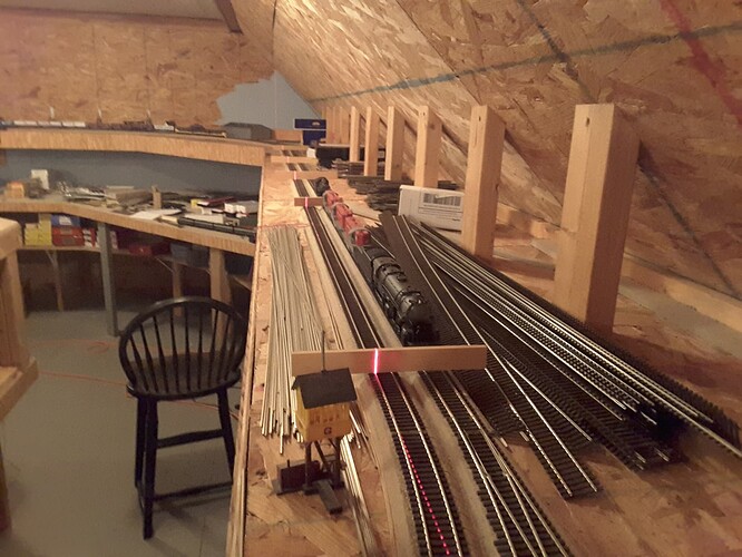

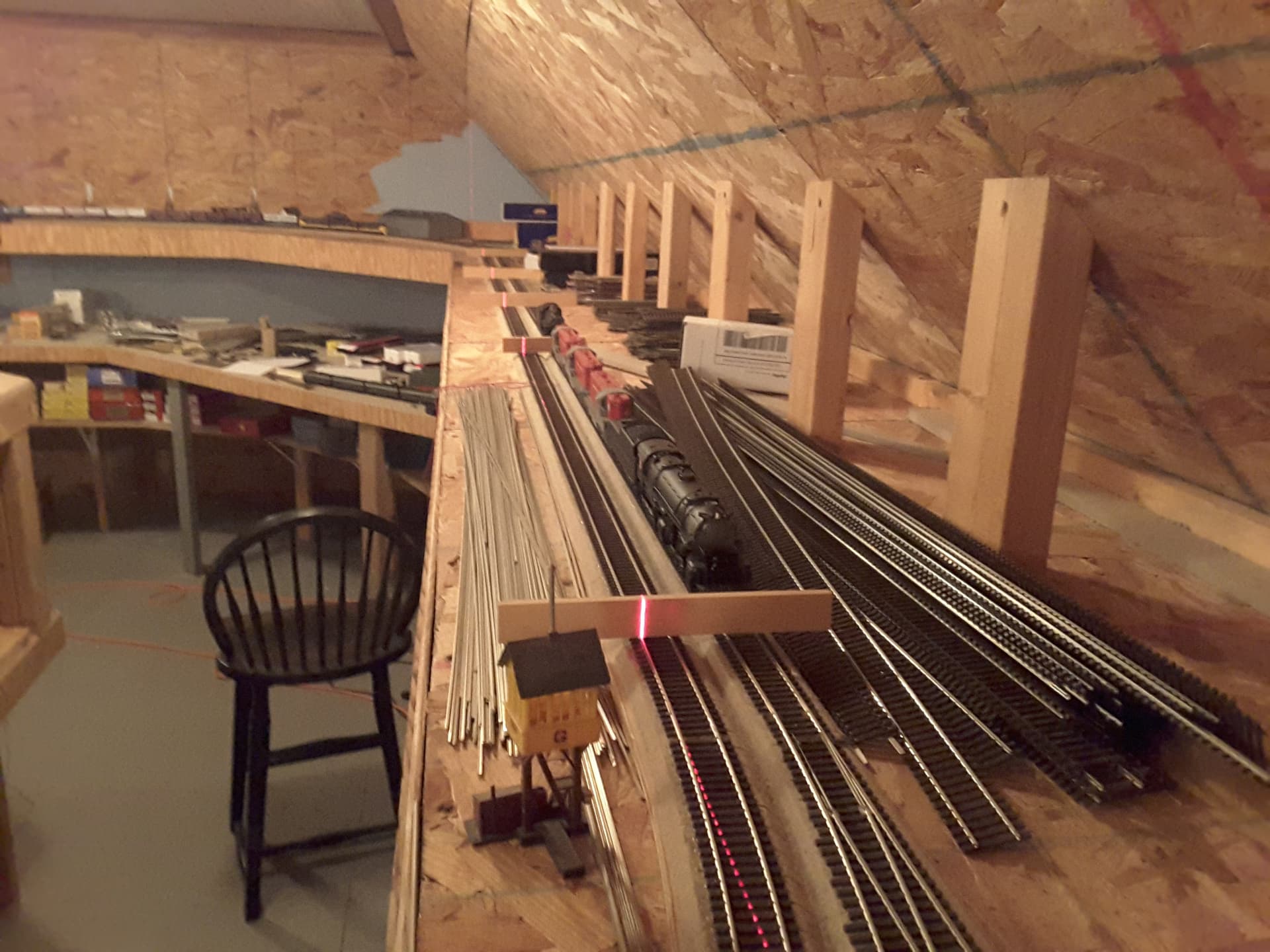

The laser level doesn’t appear to work well (frm what someone wrote in the thread I linked).
