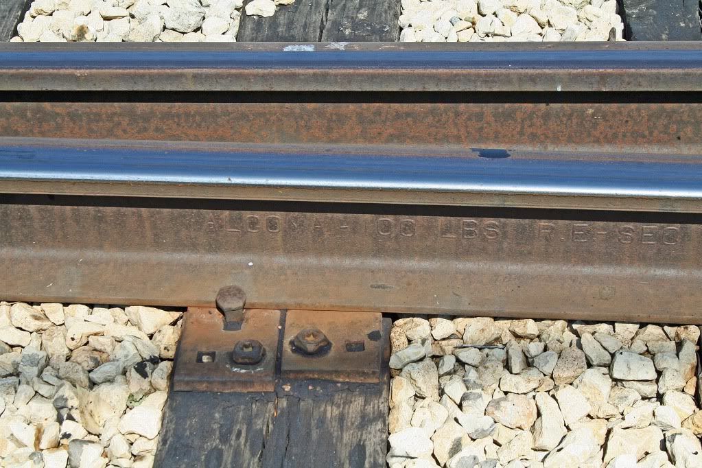

Rail is marked with information regarding what it is, where and when it was made. For example this is a portion of the marking on one rail:
This rail was produced by Algoma Steel in their Sault Ste. Marie facility. It is 100 lb rail (100 ,lbs per yard) and made with the R.E. (something) cross section. Probably out of the picture to the right was date of manufacture.
The ‘‘R.E.’’ means it is one of the American Railway Engineering Association’s standard rail sections - the AREA was the main predecessor of the current AREMA. Here are links to a cross-section drawing of it, and more information
http://www.akrailroad.com/Images/100_lb_rail.gif
http://www.akrailroad.com/rail-sections
http://www.akrailroad.com/tee-rail-sections-data
