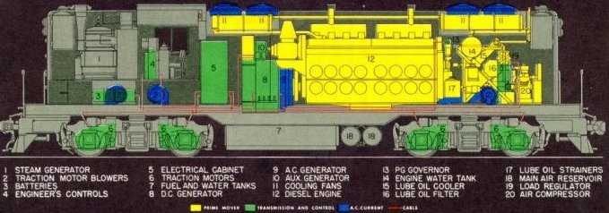

The actual steam generator is not very large, not much bigger than a big potbelly stove. Bunkerage of fuel and water more substantial, but not a large item … see how the device was packaged in an early Geep:
(Someone can find the fancy phantom-view drawings of the GG1 that were in the special Kalmbach ‘anniversary’ issue, which show the generator and bunkerage position and size in that locomotive very well…)
