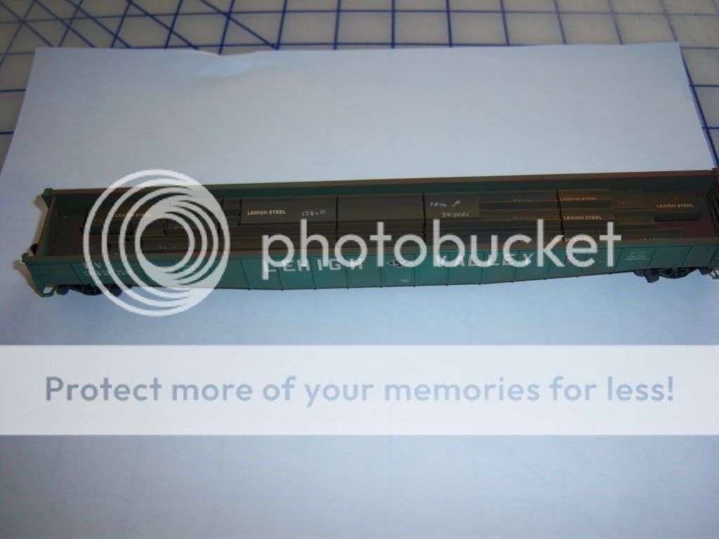

I made these (sorry for the photo quality):
