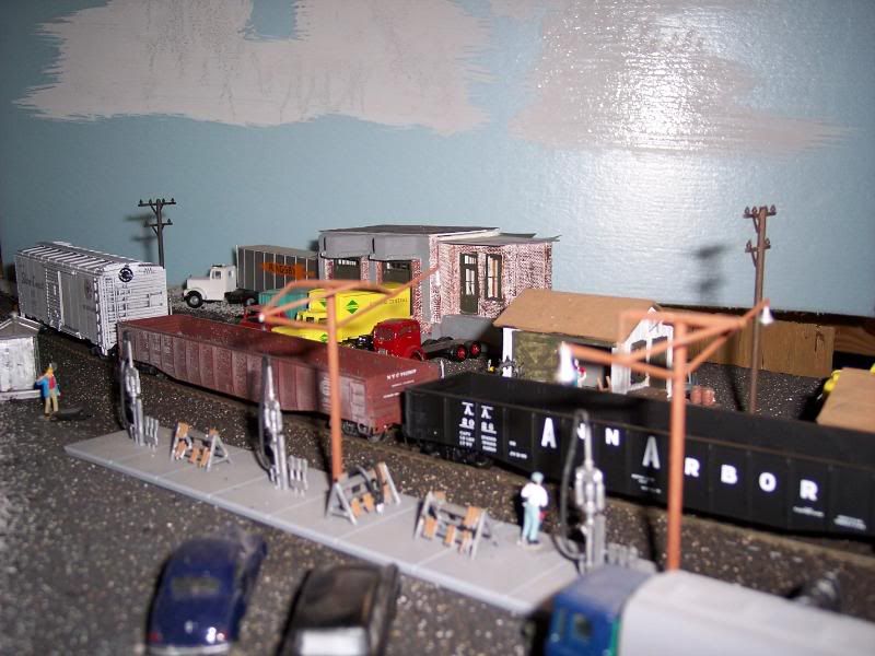

The box car on the left is new, while the box car on the right is chalk, and back and white tempra powder. The brick mortar is sheet rock mudd spread over the surface then wiped with a damp paper towel.

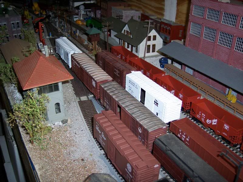

This is an early photograph, some of the hoppers are new, some of the box cars have black chalk, simple toy brand; dusted on the roofs and lighter pastels from Walmart and Hobby Lobby on the sides. I admit light weathering is what I like, but over the years I have used different chalks, powders, tempra paint powder, India Ink, and sometimes dirt all can create weathering.
Even dust.
I am not so technical that I have to use specific brands, for me whatever works-works.
