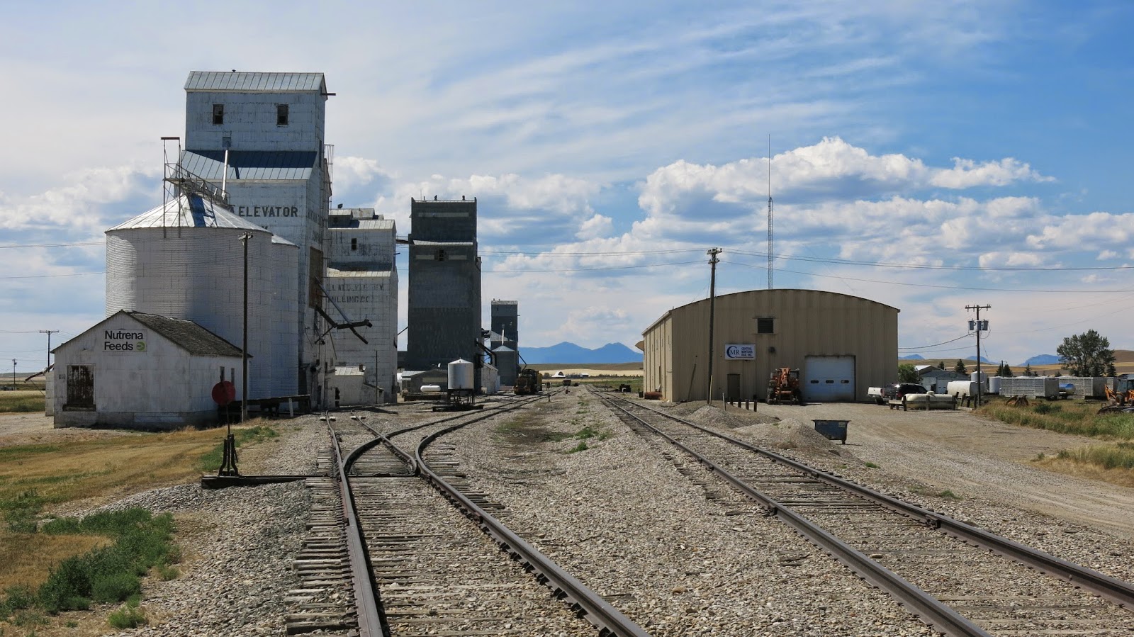

Prototypes in Montana
How do you post pictures?
