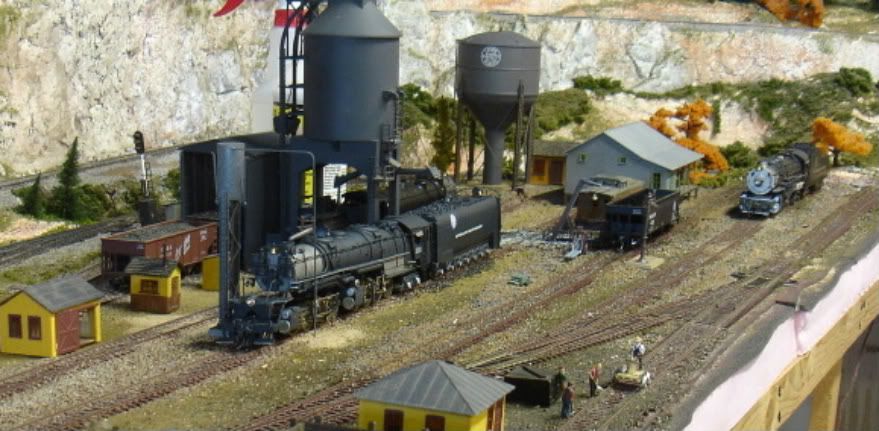

I don’t remember a MR article on the warehouse, but if you’ve got the kit, it goes together pretty easily. I’ve got one in my yard that I use as a yardmaster’s office–it’s the building near the top right hand of the photo. It’s based on a building in Placerville, CA, just about 50 miles up the road from where I live.
