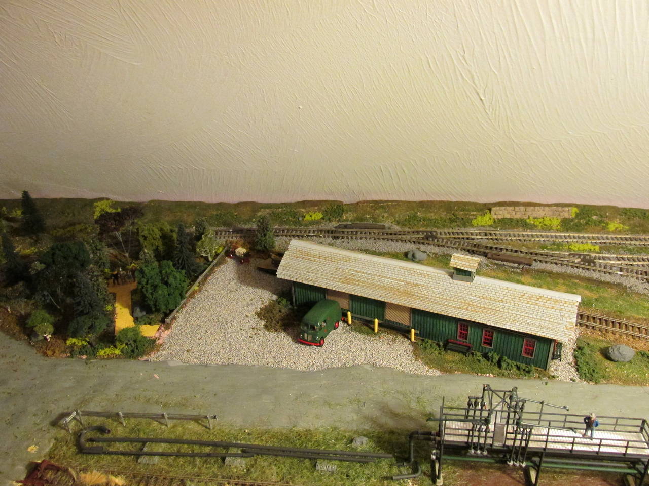

I model in HO, but I used N-scale ballast for the parking lot by the Railway Express depot:
The fine grains set it off from track ballast, and the lighter color distinguishes it from the road. This scene is in the back of the layout anyway. It’s a small parking lot with an irregular shape, and there are a lot of other details to draw the eye away from the parking lot itself.
