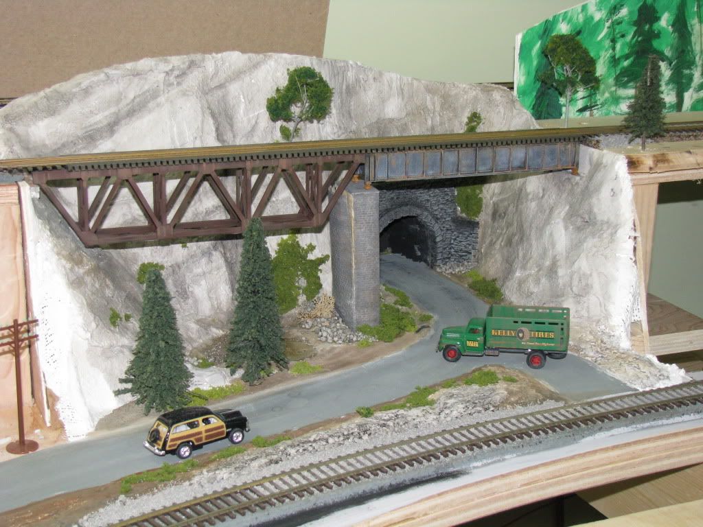

I had posted the info on foam board at the Dollar Tree stores. I used some for my roads on my HO layout and painted it with acrylics and used some white glue to hold the loose ballast and foam in some of the areas near the road surface. I had no problem with it getting soft or disfigured in any way. You do have to be careful about pressing down too hard as it will dent, although I did use this to create a couple of dips or pot holes. I posted a photo below of the road.
