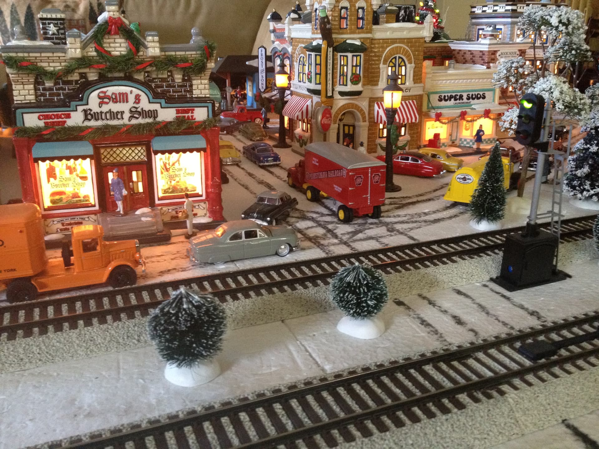

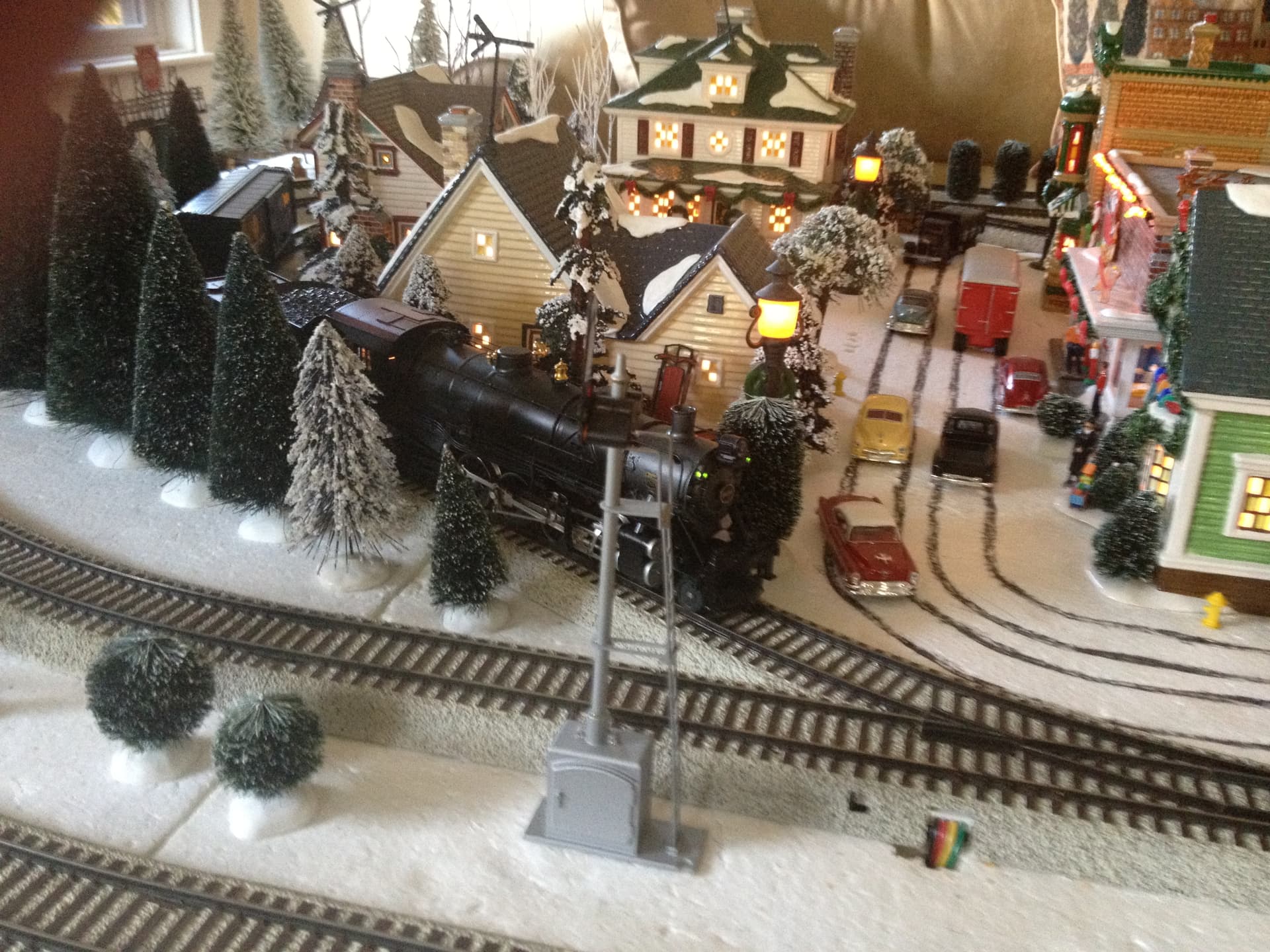

A few pictures.
They do look nice!
Those photos do look great. I have never attempted to place Dept 56 structures on my American Flyer layout, but maybe I should.
I think the Snow Village Collection buildings look great with Gilbert and other S scale trains.

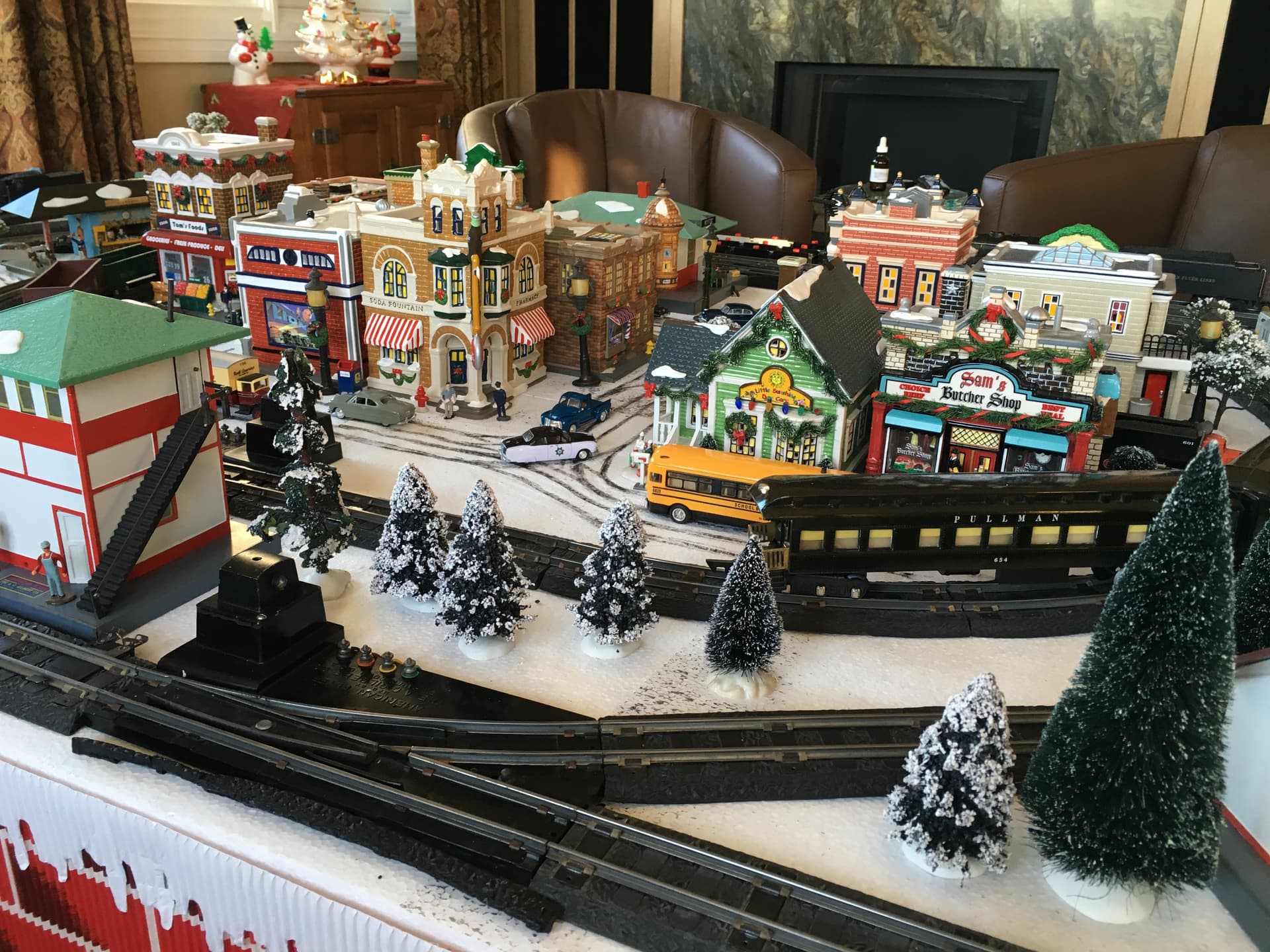

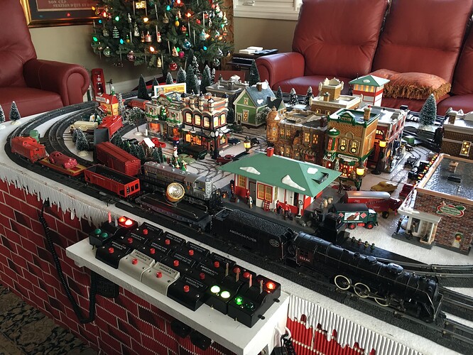

Here are pictures of another small layout I made with Snow Village, this one used SHS track.
They look pretty good with O Gauge trains as well. Since the Dept. 56 collecting craze ended a few years ago I picked up a number of buildings at a VERY reasonable price. They’re not on the layout but come out once a year for under the Christmas tree.
I’m not sure if Dept. 56 intended their articles to be a good match with toy trains but it sure worked out that way.
