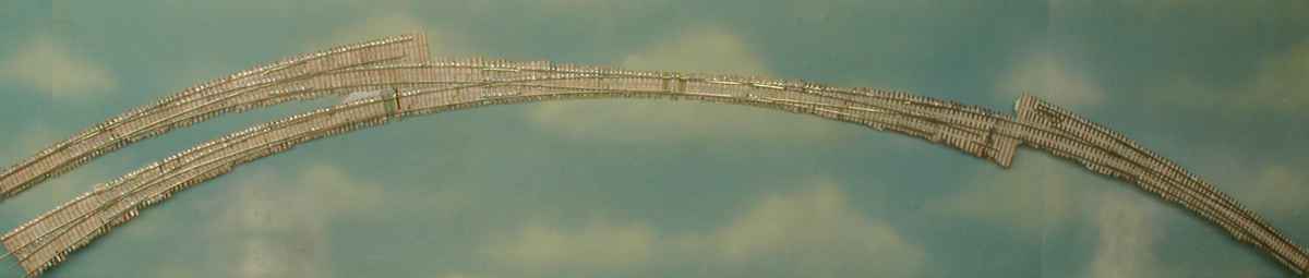

Chip, I build the standard #'d turnouts on the bench, and for reasons you would find obvious. Where I wanted custom turnouts, curved #3 wye and a long #10 curved, I first traced their paths with overlays of flex, and then drew their outlines using flex with ties on the bench. Once I knew how I would have to place the ties, where the frog had to be, and where the throwbar had to be, the rest was just placing rail lengths cut to size where they needed to go on my template and soldering them to PC ties. Your jigs will allow you to make your frogs, points rails, and your guards/wings. That was how the wye went for me. The long curved #10 was mostly built in place, but only after I had the two outer rails shaped and soldered to several ties because I wanted it to fit perfectly on my higher speed main. It gets a bit hard on the back…I suppose…but by the time one is doing such custom work, one is generally a lot more proficient and confident that it will be a matter of standard procedures.
I am pleased to say that both turnouts work well, although the wye isn’t especially pretty. Constant checks with the gauge makes all the difference. But, for me, the initial shaping and forming took place on the bench where things were flat and clean, nothing in the way of elbows. Only when I could pick up the very basic skeleton did I transfer it to its place of intent and then finish the construction. Once in its location, it becomes another Fast Tracks turnout build.

But with big ones like this it’s better to work at some type of bench.
I made the drawing, glued the sheets together, glued the ties,…
