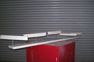

Some here may laugh, but for passenger car shells I took a scrapped, 3/8" thick resin bathroom partition that my employer threw out (thanks!).
After sanitizing it, using a jig-saw, I cut it into a rectangular shape and mounted five threaded 3/8" studs on to it and secured them with fasterners. Next, using the same partition material, I cutting a variety of 3" to 7" long blocks (3/8" wide), and drilled holes on the center of each one. Each block slides on easily on top of the threaded studs and can be turned with a finger. Total cost: $1.80 for the studs/fasteners).
Now I can spin any passenger car, carbody locomotive, or any model shell with a bottom/top opening:
On the 3rd photo you can see the small block that I used to mount the Busch Bus on.
Although I can paint up to 5 passenger car/locomotive shells at one time, I’ve cut back to airbrushing a maximum of two shells at one time. I realized that I wanted to enjoy the process and feel relaxed rather than putting unnecessary pressure on myself to “Get it done!” [;)][:P]
