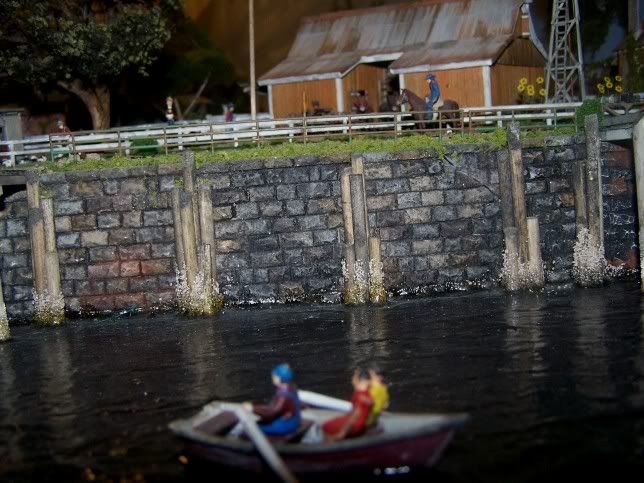

I made my Harbor Walls from plaster castings using liquid latex and a section of a “Chooch” retaining wall. I measured my master for the correct height, then duplicated the rest until the wall was complete. To hide the edges of each wall, I made pilings of different lengths out of 1/4 dowels.
Here is a pic showing how it came out:
And how’d you do the barnicles?

The barnicles are made using “n” scale ballast. To get the water line, Dump your ballast in a deep dish or pan. Then Dunk your pilings in a mix of water and glue to the a height you desire, wetting the pilings with the glue/water mix. Then dunk each in the pan. The glue will pick up the ballast to that height, hence you got a water line established!
Bob.
Great! Now I’ve got to get some Z scale ballast because I’m in N!
