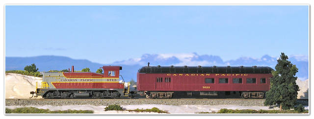

Yes, I ballasted my EZ-Track on my first layout. I didn’t like the plastic, so I used fine local beach sand, and I think it improved the looks immensely. You just need to be patient and to lay it on as thin as you can. I found the bit I could get between the ties was quite convincing. If you take your time and patiently groom a two or three foot section in one session, you will be rewarded I feel.
Here is a small 24" diorama I made with EZ-Track that I ballasted with the beach sand. You can decide for yourself if you think it looks realistic.
