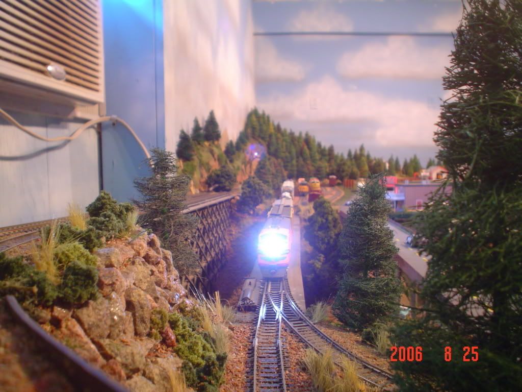

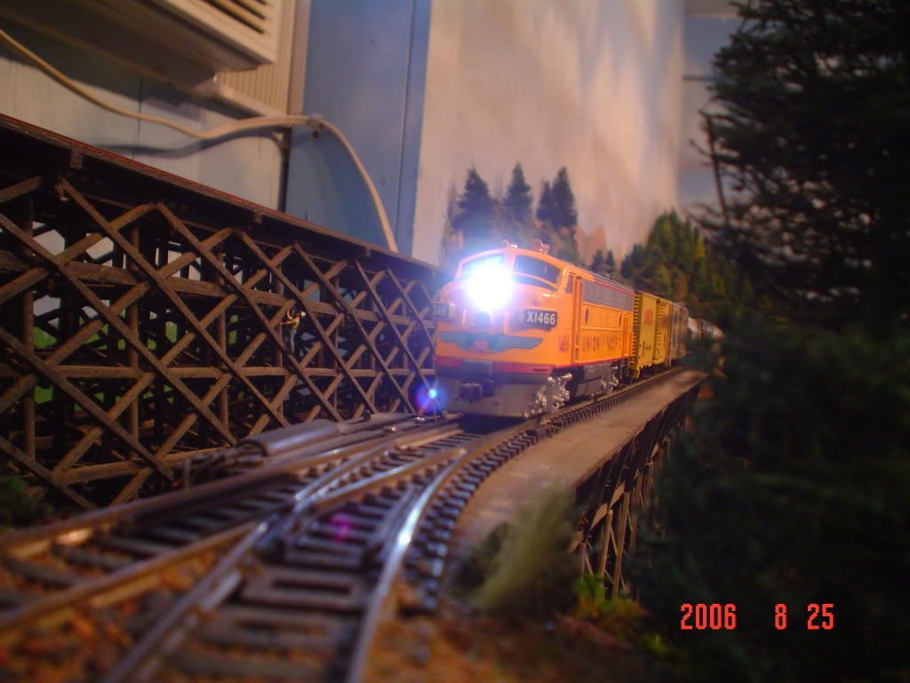

I just put a bright white LED in an F7A Took out the original light and replacer it with a 900 ohm resister and a LED. Man what a light!!! Comming out of the tunnel or through a grove of trees, looks like there is a flashlight fastened to the loco. I am looking fordward to tonight.
I am running HO in DC. Mike
You like em like I like em. Bright!
Some may say too bright but I think its great. If you decide you want a more “golden” glow just pick up a bottle of Tamiya Clear Orange paint. White LEDs are much cheaper, so you can save your money by dipping them.
Bright WHITE.[:(] With BLUE overcast.[:(][:(]
