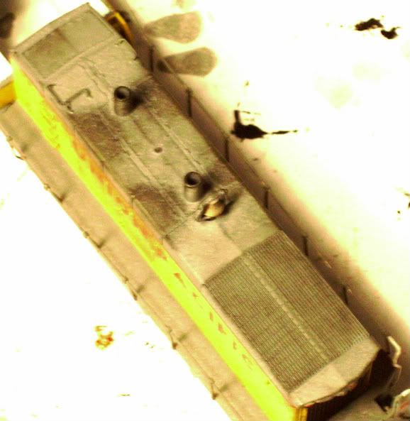

HELP! Dullcote not working

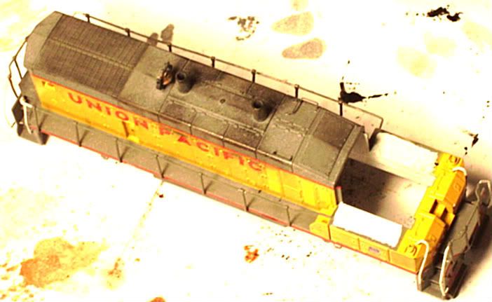

I am haveing a problem with my dullcote. When I spray it on a model it apears like litle patches of “snow” or litle snow flakes that landed on the model. I am using it in an airbrush thined 50/50. If I am doing anything wrong please help. Bellow are some pictures, you can sort of see the “snow” on the top of the long hood of this UP SW1500. I adjusted the light so it is easyer to see.
Thanks in advanced for all you help.
Joe

What kind of thinner did you use? Clear coats are lacquer, and I think they can only be thinned with lacquer thinner. If you used enamel thinner or water, that could explain the “snow.”

I checked and I was using an enamal thiner, and on the back of the dullcote it says use LACQUER thinner, I was planning on going to the LHS on fri so I will get some lacquer thinner then.

Forget what the others have suggested, I think Darth has put you on the right track. If you were using enamel thinner then you will have problems. The dullcoate hasn’t really been thinned, but instead is in suspension in the enalmel thinner. The two a chemically not compatible. Get a quart of lacquer thinner at your LHS (Local Hardware Store) in this case.
My recommendation is to avoid the spray cans. You have very little control over the application of the Dullcote. The spray pattern is to wide and the atomization is not as fine as you’ll get with an airbrush. You will sooner or latter run into a problem with the tip clogging or worse partially clogging and causing the spray to be even worse. Stick with the airbrush. my painting guides say that 50/50 with lacquer thinner is the right mixture. The other variables then are air pressure (I like around 20-25 psi depending on the application) and moisture. Clear coats can be affected by the moisture in the air. make sure you have a moisture trap installed on your air line. Along the same lines of what Darth said, Dullcote and water dont mix either and can cause problems.

Humidity and temperature can cause this too. And the base color paint has to be completely dry.
Thanks for your sugestion, I will hopefully be able to get some tomarow, dose it mater what brand of lacquer thiner I get or can I use any lacquer thiner like 2 oz of tesotrs(recomended) vs 1 quart ACE hardwhare generic brand?
BTW Im using testors dullcote, relativley low humidity and temp in mid 50’s(in my basment), and the base paint is dry(factory paint).

I use the quart can lacquer thinner from the local harware store. In my book, lacquer thinner is lacquer thinner. I use it with Testors brand Dullcote and have no problems like you’re experiencing. You can get the 2oz testors but you’ll end up buying a lot more for what is chemically the same stuff.
While the humidity maybe low in the basement, the physics of compressing the air will want to force the moisture in the air to condense, similar to why you see water coming out of the tailpipe of a car. This condensed water can form in the lines and then be blown through them and into the airbrush causing poor finishes, splattering or splotches.

Hello MJ, - Sounds like you’ve found the solution. Let us know of your results. As mentioned enamel and lacquer based solvents are incompatible with each other while in liquid form.
