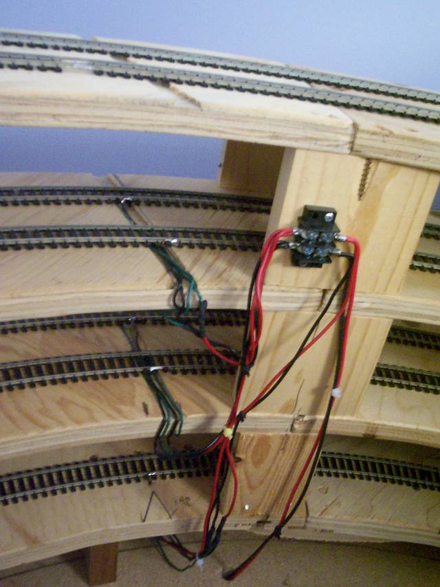

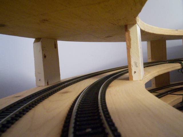

Here is a few shots of my helix, 24.5 and 27.35 rad Used 3/4 ply as it was free, (roofing job short cuts) cut in quarter turns, routed slots for wire feeds, if interested e mail me…John
