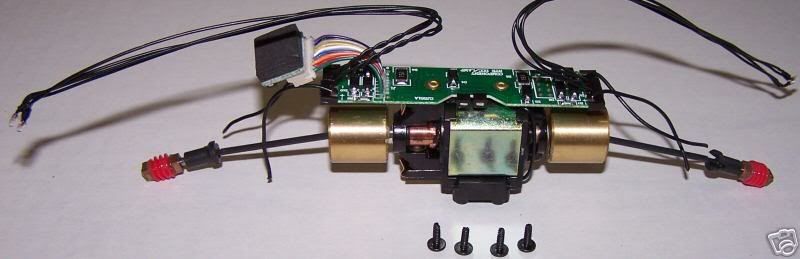

SD60, does the motor look like this? These can be serviced.
It does but the SD40 has that PC board on it and the flywheel and i dont think you can get the pc board off unless you rip it off! I dont know its wierd i have never had an athearn that sounded so bad. If it can be serviced i will have to send it to athearn because the hobby shops in Memphis suck they dont know anything about model trains!
I found a photo of the motor with the circuit board, and the board is just riveted to the top contact. Both contacts pry off from the brush end of the motor, then the springs and brushes will come out. If you don’t feel comfortable trying, don’t, but these motors are easily serviced. Does the armature turn freely, or is something rubbing?

Re-seating the top brush spring must be a lot of fun with that board attached. Doh.

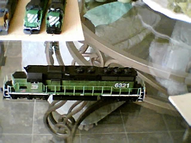

This is the unit in question i took it yesturday when it worked also im just going to use an old motor to fix the SD40. The Motor is from a BB GP50 and im going to make the 50 a dummy until i can get the 40’s motor fixed. Thanks for the help guys!
