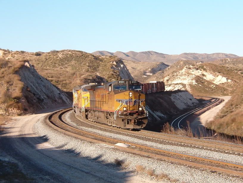

I’m sure that this topic has come up before but I need someone to point me in the right direction on what I can do and the techniques thereof to go from Picture 1 to Picture 2:
I have a number of engines that I would like to do this on. I model HO scale and I will be using DCC.
