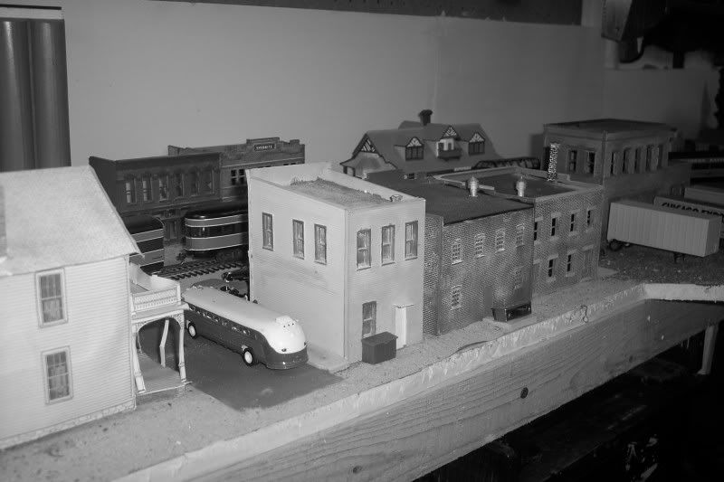

I tried this one by adjusting my 6 megpixel Kodak to black and white.
Early morning on the WTRR

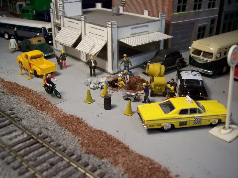

Busy Work Site
Morning work site, busted water main. I used a 100 watt light bulb with a glass relector and there are some flourecent work lights above.

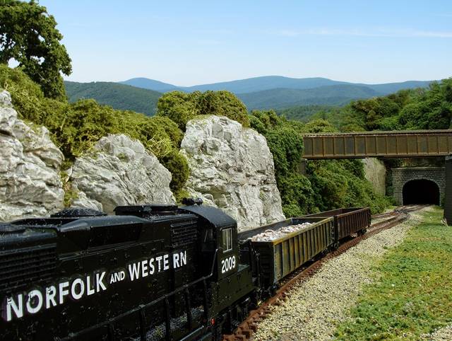

  5. Once you have those processes down pat, and do them routinely, start using a freeware stacking programme. You take several images with the camera in the same orientation, but focused progressively deeper into the scene, and let the image stacker do as its name suggests. You get tremendous depth of field that way. See below:
Crandell

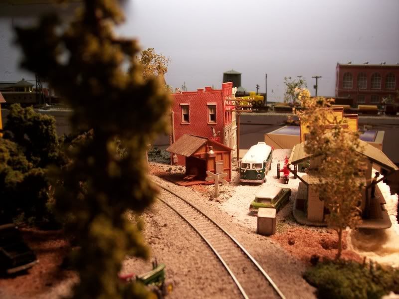

All my imagery has been done with a Canon P&S Powershot A710is…F8.
This one was done prior to my exposure to CombineZM and later ZP.

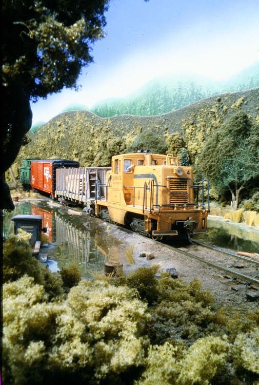

In fact, as illustrated in the photo below, stacking software sometimes works a little too well. Certain details have a tendency to show up that weren’t as apparent to the naked eye (like all the dust particles on my loco):
Great photo, Bruce. [tup]
