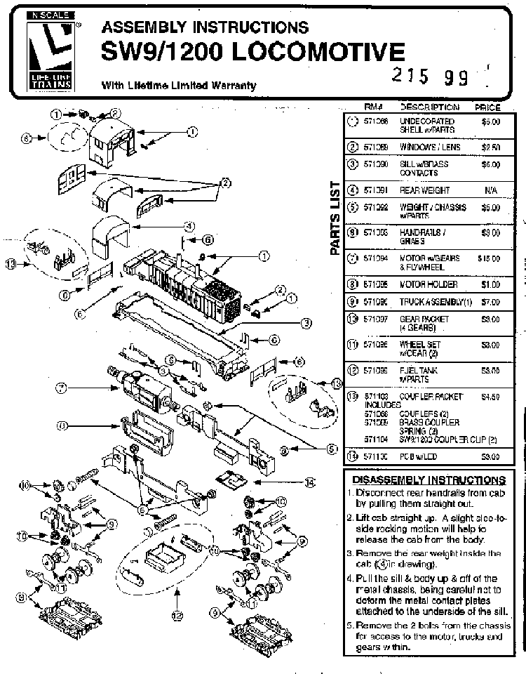

Here’s another interesting link to a decoder install in a LL N scale SW9/1200:
http://n-scale-dcc.blogspot.com/2011/10/tcs-z2-in-life-like-sw91200.html
Here’s a parts diagram:
http://www.hrccomputing.com/nscale/SW9.gif
Mike
Wow! I never saw a scan at ten dots per inch but sure enough, there it is [:-^]
Cheers, Ed
[(-D] That’s I thought too. Found it on a Google search. Someone ought to start a Nseeker site.
Mike.

Life-Like_SW_0001 by Edmund, on Flickr
Life-Like_SW by Edmund, on Flickr
Regards, Ed

Thanks for the documentation Ed, I suspect I will find it very useful whenever I need to work on that loco. Looked on Ebay, and theres a MILW shell for about $30, I have to think about it…
