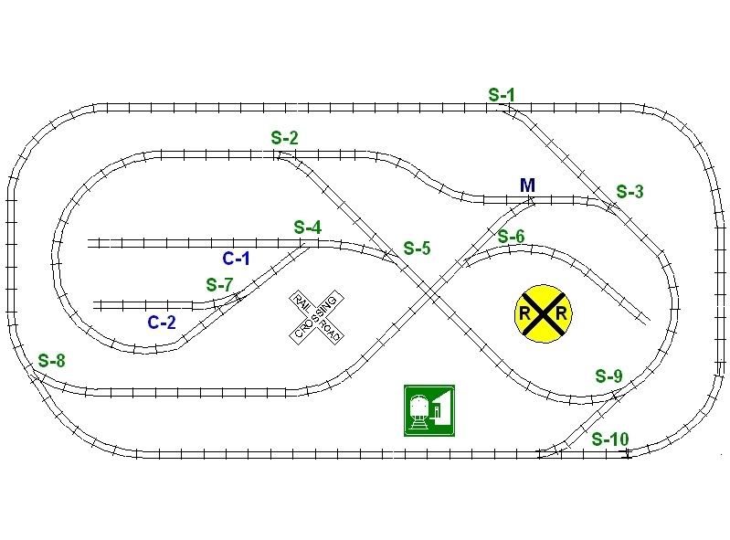

Hi, this is with O27, not fast track, but this is what we built for my Nephew on a 4x8 sheet of plywood. Had to cut several fitter pieces to make everything line up properly, and it just fits, the track is right at the edge of the table, no safety zone for a derailment (this was built on a floor level table on a carpeted floor) if on an elevated table 5x9 would be a good choice to give a safety zone for derailments.
A LOT more can be done in O27 in a small space than many people give credit for, although on a busy layout like this, you will be giving up a lot of scenery options to get this much track in, it would be a better candidate as a “Toy Train” layout than as a “High Rail” layout.

Edit- for some reason the layout image didn’t come through very well, but just click the layout image, it will go to a larger view that shows very nicely.
