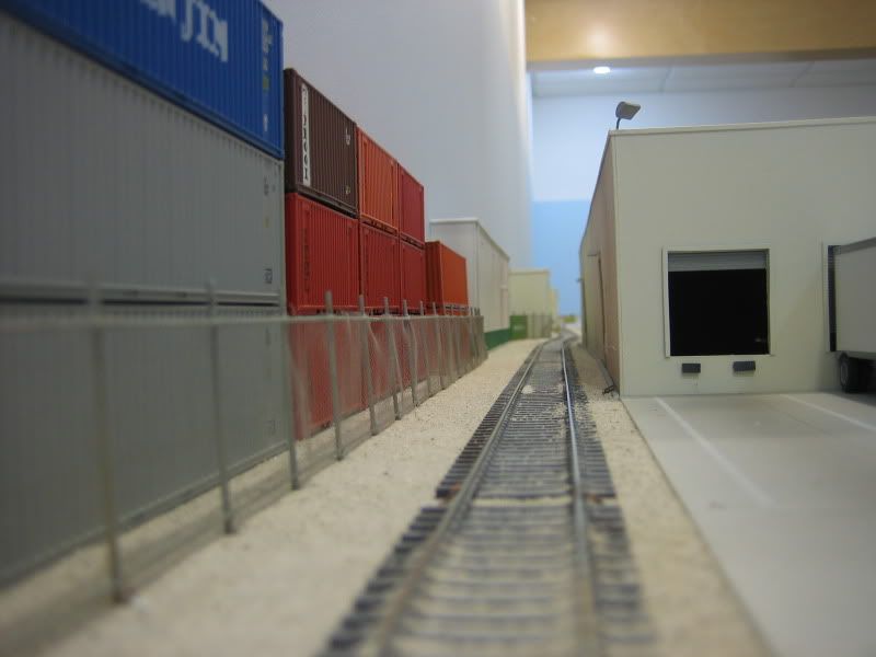

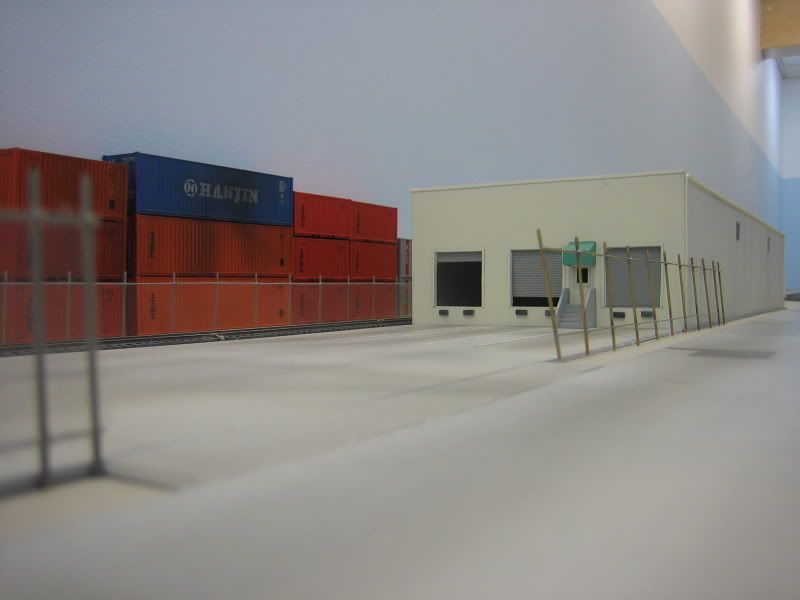

I use 100w equivalent daylight CFLs in clamp-on type reflectors:
