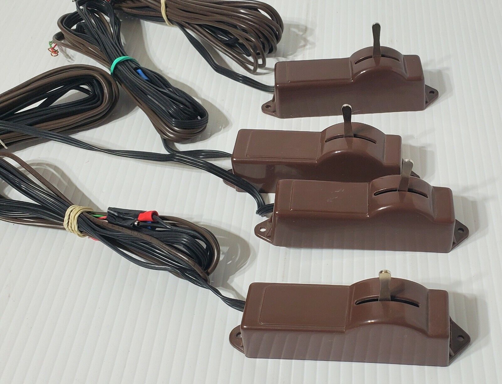

I would appreciate some help. I purchased some Lionel switch controllers separate from my O27 switches. The switches and controllers all work fine, except on the controllers, both the red and green lights are always lit. I tried changing the way the wires are connected to the posts to no avail. Any help would be greatly appreciated!
If you are using the Lionel 022 style single controllers for O-27 switches, the bulbs will stay lit by design. They will flash, though, as the control rails are traversed by a train providing a type of “track occupancy detector” feature.

X2 on what Rob said. Your 027 switches (model 1122, I presume) do not have the wiring set-up for two bulb controllers. You need an 1122 switch controller that has one bulb and the red/green lenses that let light through depending on which way the hood inside is turned, corresponding to the direction of the switch position.

Thank you all for your help. So the ones I need are the ones that have (for lack of a better description) the lenses that look like jello molds? I have seen these in both black and brown, does it matter which?
You need these:
1121c or 1122c controllers…

Yes, these will work. I have them and both of the ones ADCX Rob shows in his pix. All work on my 027 layout. the brown ones I have with the ‘jello molds’ are not lighted. I think someone added the lenses for clarification of turnout setting. This is a good idea. I stuck red & green filing poster tabs on the ones that didn’t have anything at all. Also, I keep all of them wired the same way; on mine, ‘up’ is red, or turn & ‘down’ is green, or straightaway.

If you want lights to work on the switch controllers, you are going to have to add some switches to the switch motor like the 022 switch has. I have never tried to do this, but someone else might have some ideas. Bruce Baker
