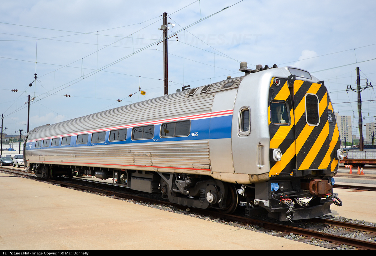

One follow-up question: For doing a car body that has both painted surfaces and the Alclad, would you mask off any areas to be painted when doing the Alclad or over-paint it in another step? I’m thinking of the blue window bands on an Amtrak cab car, as well as the yellow and black front of it.
CJ, glad the links were helpful.
An ex-Metroliner Cab Car will be a very neat project!
http://www.railpictures.net/images/d1/1/4/5/4145.1373930774.jpg
Either approach will work.
My preference is to keep it simple and “over-paint” (just like the protoype [;)]). In the case of applying paint on top of “stainless steel”: After metalizing a shell and sealing it with the gloss clear, I’ll carefully mask off the appropriate sections and airbrush directly on top of it. (Use a high quality tape that doesn’t allow bleed-through on its edges. Always burnish the edges before spraying.)
If I like the results, the next step is to apply decals, then seal with either a gloss or semi-gloss clear (depending on how much I want the Alclad2 finish to dull down)
