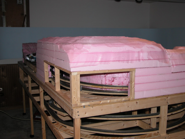

I went the helix route down to my lower level which is a staging/storage area. I put the helix in when I built the upper layout level and then added the lower level track after I had all of the main work done under the first level (i.e. turnout controls, wiring etc…) . It was designed this way from the beginning, even though the construction was in phases.
How did you plan and built the helix?
The concept is straight forward, a series of circles. Are there plans for these available or do you simply build by trial and error?
Others have some pretty good plans and can post. I just created a basic curvature form that was 1/3rd of a circle (120 degrees) with a 26" center. I then kept cutting them out of 1/2" plywood. Mine was single track so I used a width of 2.5" . If I had to do again I would go 3 or 4". Since I was dropping 12" to the staging/storage area, I wanted 3.75" clearance and exited out the opposite side I entered it took 3 1/2 turns . The grade is around 2.1 degrees. For supporting the helix some folks use threaded rod. I used L brackets screwed to 4 vertical 2"x2" pieces of wood in the center of the helix. The brackets then go under the 1/2" roadbed. The threaded rod is easier to adjust but with being only 2.5" wide, there was no real easy way to attach threaded rod too the roadbed. Thus I went the L bracket approach. I used 3" L brackets and added them as I added each layer. I started at the top and worked towards the bottom (since I finished the top first.
I hope this helps a little.
Edited 2/27/2008 -
I thought a picture might be helpful. Here’s an early construction picture of the helix showing the bottom portion of it.
