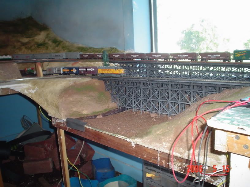

On my HO layout I have 12 or so turnouts, and do not like the look of the switching machines on the side of the track. Is there a way of hidding them? Some are accesable from the underside of the table and some are on a mountain side or on the ekit of a trestle. Another thing, has onyone ever used Model Power foam roadbed. Mike
