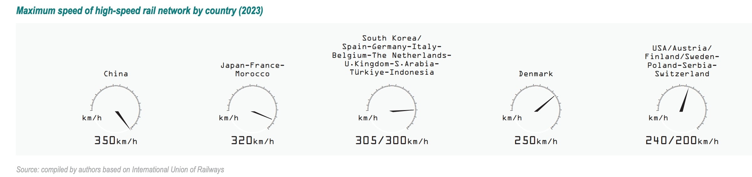

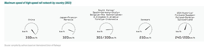

I attatch a quick peak at one of the exhibits.

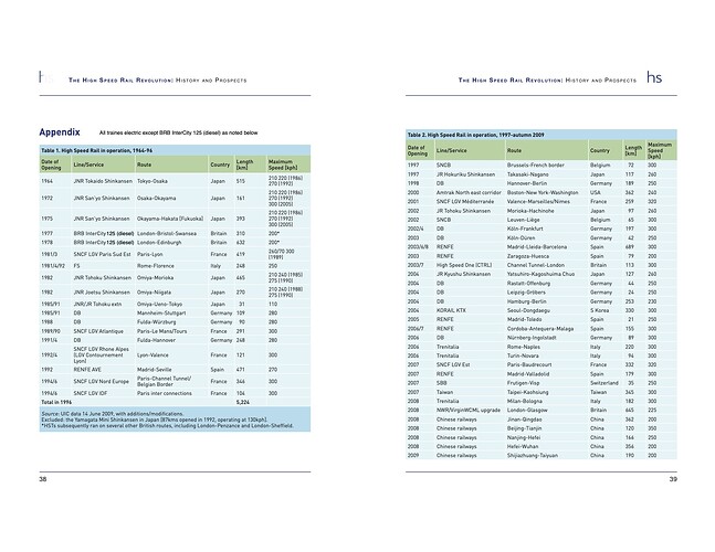

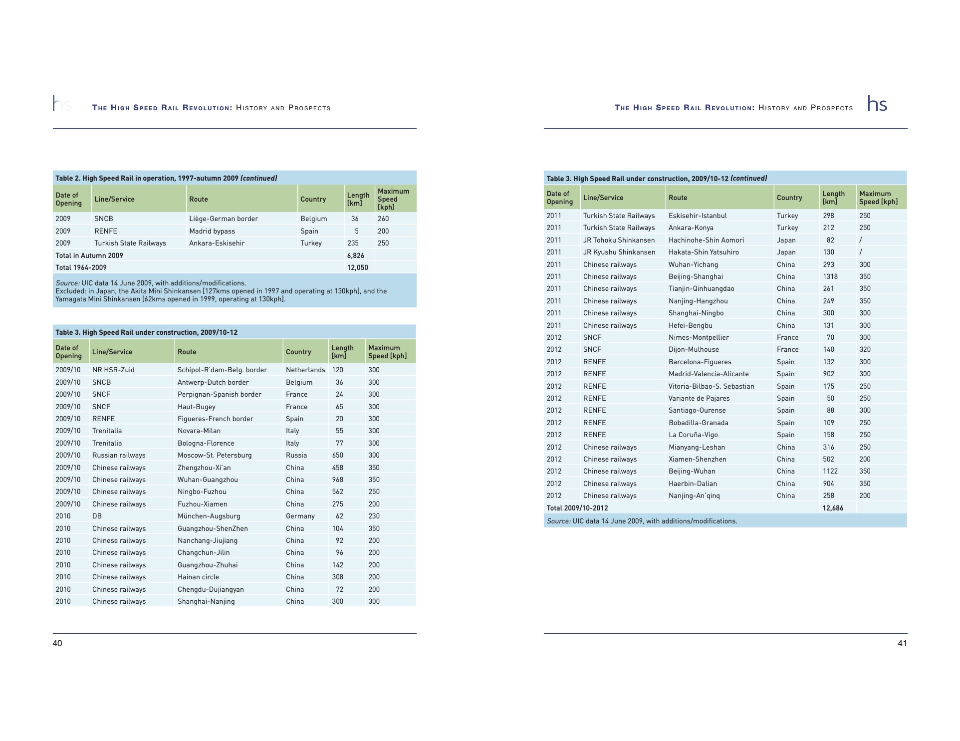

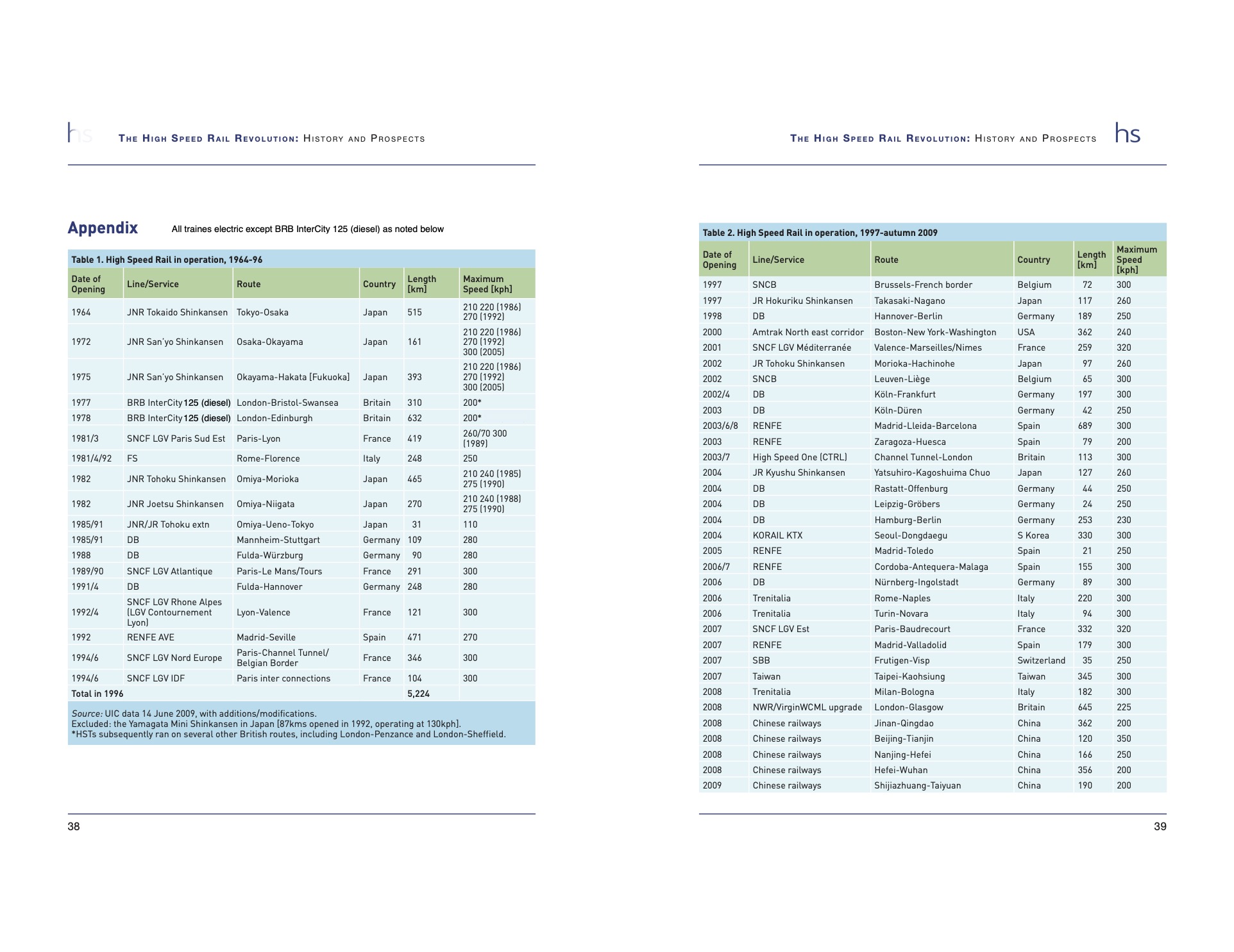

In addition I have attached a couple of pages of lists that show nearly all of the services of 200 km/h (125 mph) in chrono order from the first Shinkansen in 1964 in Japan to 2012. Unfortunately this chrono list only goes to 2012. The PDF includes everything to 2024 but has no updated chrono list like this.
