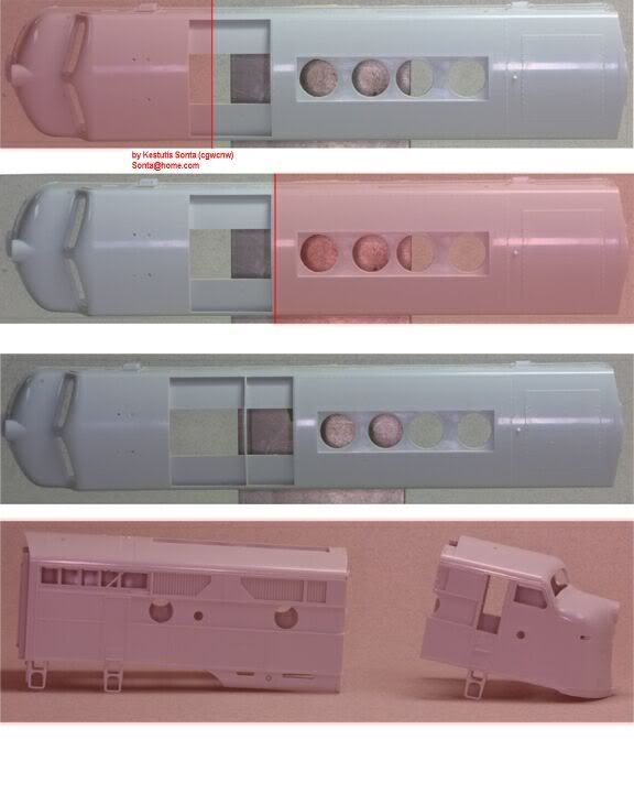

What makes you think that they will be releasing an FP7 shell mod kit? In order to mod a Highliner F-shell into an FP shell, you’d have to cut it up a couple different ways (both in front and behind the prime mover)…and the Highliner shell doesn’t exactly have a lot of material in it in the first place as it’s a little delicate. IOW, you start cutting it up and it’s not going to go back together like an Atlas F-unit shell. For them to do any FP (or even FL) types, IMHO it would be all new tooling.

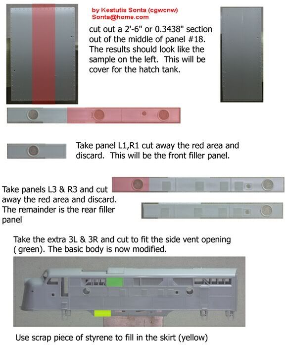

Here is how you cut up two Highliner F7’s to make one FP7… I think Highliners new kit will make it easier to put it back together and make a FP7. Maybe they will even include one half of the body so you don’t have to buy two F7 kits plus an FP7 kit??? Wouldn’t that be nice [:)]
Wow. I am surprised to say the least. I wouldn’t think that making an FP7/9 out of a Highliner shell would be in the realm of $20 kit.
