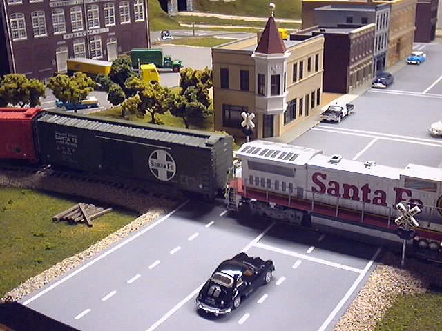

The darker rectangles are asphalt “patches”, and the little black spots are supposed to be cracks filled-in with tar.
Remember, stripes on prototype highways aren’t always perfect; sometimes the faded paint of old striping will show beyond the edge of newly-painted stripes, and other times the driver of the paint truck may be startled, causing a squiggle to appear in an otherwise straight line.
